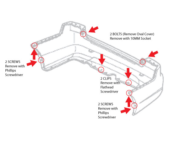

how do you take the bumper off? there seems to be 2 tabs there the trunk closes over, im guessing those are screws, anything else needs to be done?
Old Jan 25, 2007
CraigW's Avatar
Joined: Mar 2005
Posts: 4,904
Likes: 14
Rep Power: 309
CraigW is a glorious beacon of lightCraigW is a glorious beacon of lightCraigW is a glorious beacon of lightCraigW is a glorious beacon of lightCraigW is a glorious beacon of lightCraigW is a glorious beacon of lightCraigW is a glorious beacon of light
This was provided by someone here --->

thanks craig thats solves everything!
Old Jan 26, 2007
bcdjr100's Avatar
Joined: Jan 2007
Posts: 25
bcdjr100 is an unknown quantity at this point
Well I appreciate it craig, but I bought one of the Haynes repair books and it has all that in there, however, that image looks a bit simpler than the one in their book, so I may end up using it. However, the temp has gotten to about 5 degrees here so it will still be a ways till the lights (front and tails) go in.
