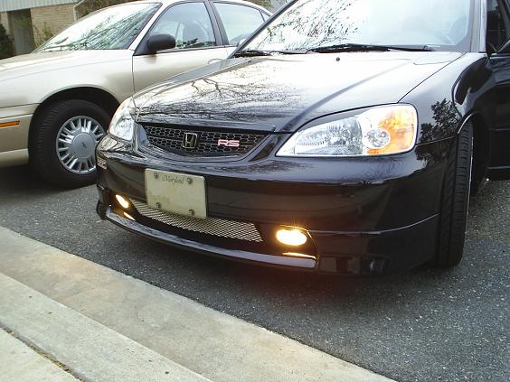

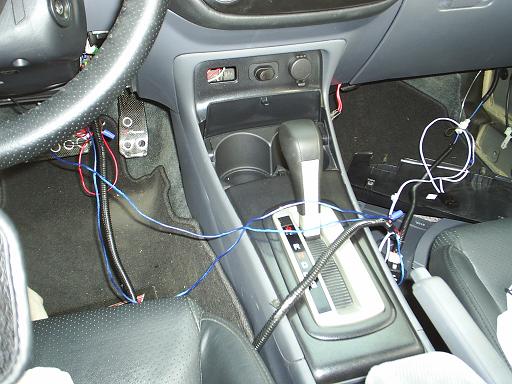

So finally after getting off early I have the time to troubleshoot these bad boys and finally got them working. Thanks gear that link you sent me made me understand the simplicity of relays... just have to think of it as a triggered switch almost. Either way after using a combination of wires and plugs that came with the set and my own, and omitting the damn crappy switch, I got them to turn on automatically when I turn on my parking lights and headlights. Cool deal. All it cost me 35 bucks, some time, and some frustration. You'd think that since I deal with electricity everyday I would have got it sooner...
