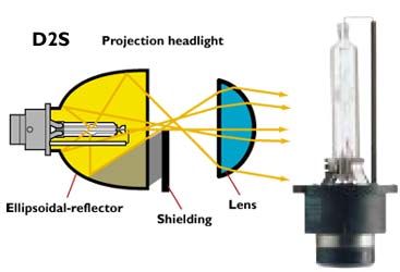

so whats the difference between d2s or d2r?

d2s = projector use
d2r = reflector use
for example: those flashing blue/white lights you see on bmws, audis, newer maximas, s2000s, etc, are from a projector and a d2s bulb. the constant bright white/hint of blue or purple you see on older acura TLs, RLs, CLs, some mercedes, many nissans, etc, are from a reflector (like your civic) and a d2r bulb.
the way i remember it is:
D2R = reflector
D2S = not R...
