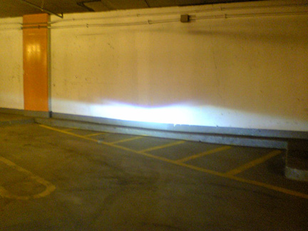

So as posted earlier I got the retro put on today. Tonight, I had a chance to check out the beams and what not. The cutoffs look good, however I have to re-aim the beams a bit.. I just wanted to know if there was anything in particular I should know before re-aiming them since this was a custom job. I need to move the driver's side over about 2 feet to the left or so and about a foot or so higher, and the passenger's side over to the left about 2 feet or so.
Also, I noticed that the high beams indicator is half lit, even though they are not on? Did you have this happen when they were on your car? If so/if not what should I check out to try to solve this? And, if I flash the high beams or turn them on, the HIDs shut off.. Is there a way to get around this and/or install the high beams also? Thanks in advance!
Included are a cutoff shot on a wall to show the current aiming

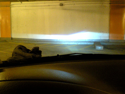

I went down to a parking garage downtown today and re-aimed the projectors using the "DIY 01-03 Headlight Aiming" http://www.7thgencivic.com/forums/sh...adjustment+56k
method. They're more aligned now so I'll hope they stay like that. Other than that I don't think I've had any problems.. So for now, the only thing is the semi-lit brights indicator lamp, but even that's no big deal..
One other thing I noticed is that the cutoff on the passenger's side is more pronounced than the driver's side.. Are there any specific reasons for this? Again, it's not that big a deal, but it would be awesome if I could get it sharper at the cutoff.. Thanks in advance again

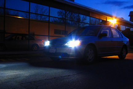

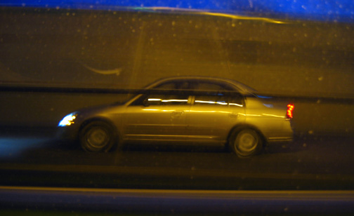

I was thinking of getting some bulbs.. Gotta search on here for the size. Drove it some more tonight.. It's amazing how much brighter/clearer things are with HID.. Still gotta fine tune the aiming sometime a bit more. Anyway.. here's a couple night shots
*the first picture is a long exposure time (>2 seconds) which is the reason for the glare*
