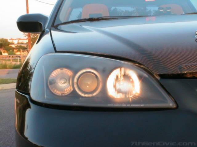

Hey, I have heard from someone that these headlights break easy, or sometin inside them breaks. Has anyone had any problems with them, or know ne other info that would be helpful? thanks

the actual headlights do not break...
the halos inside the "halo projectors" stop working after awhile...
go with TYCs, you wonthave a problem

the "halo projectors", is that the ring? or the whole centre bulb part? can this replaced and if so, how much?

the halo = the ring. you can replace the LEDs but that requires opening the headlights. i don't think you're quite ready for that yet, considering you don't know what the halo is...

^haha true...i have those on my car now and the only problem ive had is the fact that it foggs up like a bitch...other than that, they look hot

Aside from the halo ring, are there usually problems with the centre bulb(LED) inside the ring? Even if the ring stops working? is the headlight still good?

light output will suck.

I've had both Sonar and the twin halo projectors on my car all of them are complete ****!! I mean I had problems fogging up, glare and simply mediocre light output, I am yet to try TYC which works best with or without HID at least what I've heard so I was stubborn and didn't listen what I've been told "projectors only look good" and now I finally agreed.

hmm... im pretty sure that Im gonna silicone the edges so that moisture cant leak in.. and as far as the mediocore light output.. i guess ill have to live with it..worst comes to worst.. use the the high beams.

I got the sonar's and they looks clean but the problem is you gotta aim the projectors. Remember that they don't usually come preaimed and aiming them can become a hassle. Another thing one of my halos started tripping the other day. While it's on my left halo blinks rapidly i think it might be going out.

Dudes, listen...the halo is just decorative and it's lit up by its own led bulb! It will have NO EFFECT on the brightness of the low and high beam bulbs if it burns out. Your low beam will always be the same brightness and can be replaced just like any other stock bulb when it burns out.
FYI, your projector will use H1 bulbs instead of the stock H4's. One H1 for the low beam and another H1 for the high beam. H1's are much smaller so they tend to be kind of dim. I'm using Sylvania silverstars in mine and they're about as bright as you can get for H1's, IMO. Like others have said, Projectors look good but they don't light up the road all that great so think about what you want to achieve when buying/installing projectors (either looks, or functionality, but you can't get both!)
