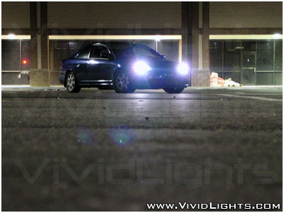

Originally Posted by ImPulse
No, RiceBoy did it,
PM me if you have any questions...
the file pissed me off because it took way too long to file out as much as you need to in order for the bulb to clear, so i used a drill..

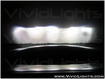

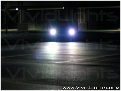

wow, so those pics are the h1 HID kit on Halo projectors?
Old Sep 13, 2004
ImPulse's Avatar
iTrader: (32)
Posts: 8,407
H1 kit in TYCs

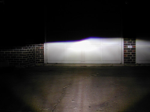

yup, and you can see why you should NOT put HID's into projectors that were not made for HID.
The beam pattern is horrible and has discoloration in the pattern too.
That one on the wall is soooooooo bad.

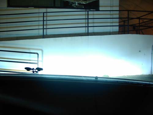

compared to this,
http://www.intellexual.net/hids/ece.jpg
Yes... Its not great
compared to this,
http://www.intellexual.net/hids/5.jpg
Its amazing...
I' am still surprised that the TYCs even have a cutoff
I dont see why its so bad. I bet u it lights up the road better than halogen in OEM housing, or halogens inside a projector. Yes, its not as good as a retrofit, but not everyone has $500-$800 to spend on just lighting. For 280$ i think its worth it. Pics are nice, and u can see the improvement. Its not like this was for nothing. Nice pics riceboy.

here you go
ID:	37952   Click image for larger version

Old Sep 14, 2004
Hefe's Avatar
Second Place is the First Loser
Joined: Oct 2001
Posts: 4,469
From: San Antonio, Texas, US
Rep Power: 345
Hefe is a jewel in the roughHefe is a jewel in the roughHefe is a jewel in the rough
Impulse....
Compared to the actual HID projector, yes id doesn't compare.
But against that ugly H4 Civic Hatch with the fluted lenses with massive glare, yes it is somewhat better. Just cause the TYC's do have a decent cut-off, (except the "bubbles" coming up on the sides)
But the overall pattern is still ugly and discolored, yes it is "brighter than stock or stock projectors"
