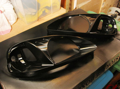

heres what gets painted
those are from a 6thgen civic SI's headlights. but u get the idea. its basically the piece that comes apart from the headlight in between the headlight and the clear cover. its right in the middle being held in by a screw. u cant miss it. just look at pictures of people's 04 05 headlights that have been blacked out before n u can tell which part it is.
