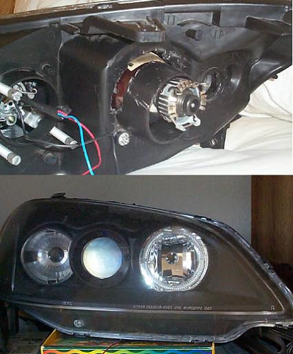

you still had to cut out the back tho correct?
Old May 12, 2004
Rufus's Avatar
Posts: 9,137
From: Ontario
Rep Power: 379
Here's what they looked like when I finished them initially.

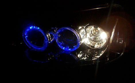

Old May 12, 2004
Rufus's Avatar
Posts: 9,137
From: Ontario
Rep Power: 379
Since then I've painted the bezels the NBP to match the car and put in another halo.
