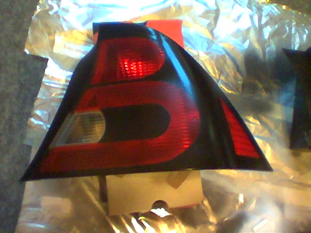

here is a pic, i will have better ones later..

Judging by the pic...they look GOOD!! Nice job!!
Did you use a template or did you just tape that ish off and spray away? This maybe something I might look into doing. Thanks!

yea, that looks nice
lets hope it holds up ^_^

yea i taped it all out and then used 1 coat of a Dark gloss black, then a very very light coat of a metallic black overtop (but maybe you could use a light blue) and then about 6 clearcoats overtop of that. I found by using a thick coat last on the clearcoat makes it look glossy and good to match the car...i would only suggest doing this on a black car though...thanks guys i will have pics up soon
