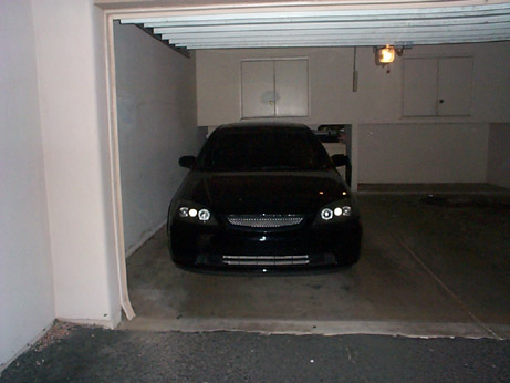

OK I've had these done for about 3 months but I've been too lazy to post these pics. Now everybody will hopefully quit yellin' at me. Oh well. The projectors are out of an Audi S4 and I retrofitted them into Sonar projectors. I removed the LED from the low beam and transplanted it to the high beam with 2 new T1 LED's. Yeah one of my blinker lights is out. I'm working on it. Well, enjoy. Dallis

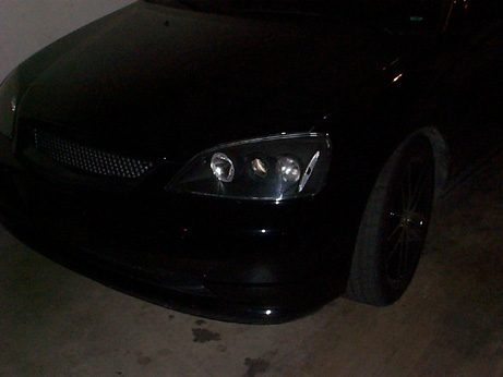

Future plans include:
New lenses - These are all ****ed up.
Painting the insides NBP.

Hmm, maybe you want to get two more angel eye rings and put them back around the projector, I dont even think you would need to hook leds up, its just it looks kinda wierd without anything around the projectors...Any plans for a diy on this??
Oh and if you paint inside, are you talking about the plastic, because that might be interesting...

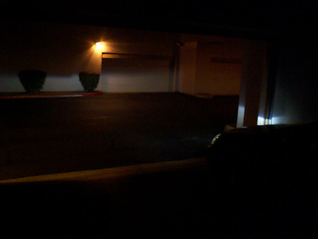

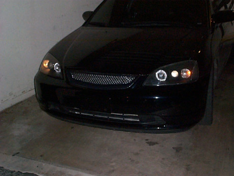

It was so easy I'm sure I won't end up doing a DIY. Well that and because I didn't take any picture when I took them apart. The Audi projectors fit almost perfectly onto the Sonar projector brackets. Just a few extra threaded rods and it worked perfectly. It's the wiring that is the pain. The HID ballasts need more power to start than conventional lights and need to be hard wired to the battery with a relay. Once the lights turn on the relay flips and they run off of the stock wiring as they use LESS power once started than conventional halogens. And yes I will be painting the plastic. I'm most likely going to bondo some of the surfaces inside to make the housing look more custom. I was considering airbrushing flames on them when its ready.

The sonar projectors...what are those, the halo's right? How is the visibility now with the retrofit?

Sonar is the brand NOT TYC. Visiability is better than any civic I've EVER been in.
