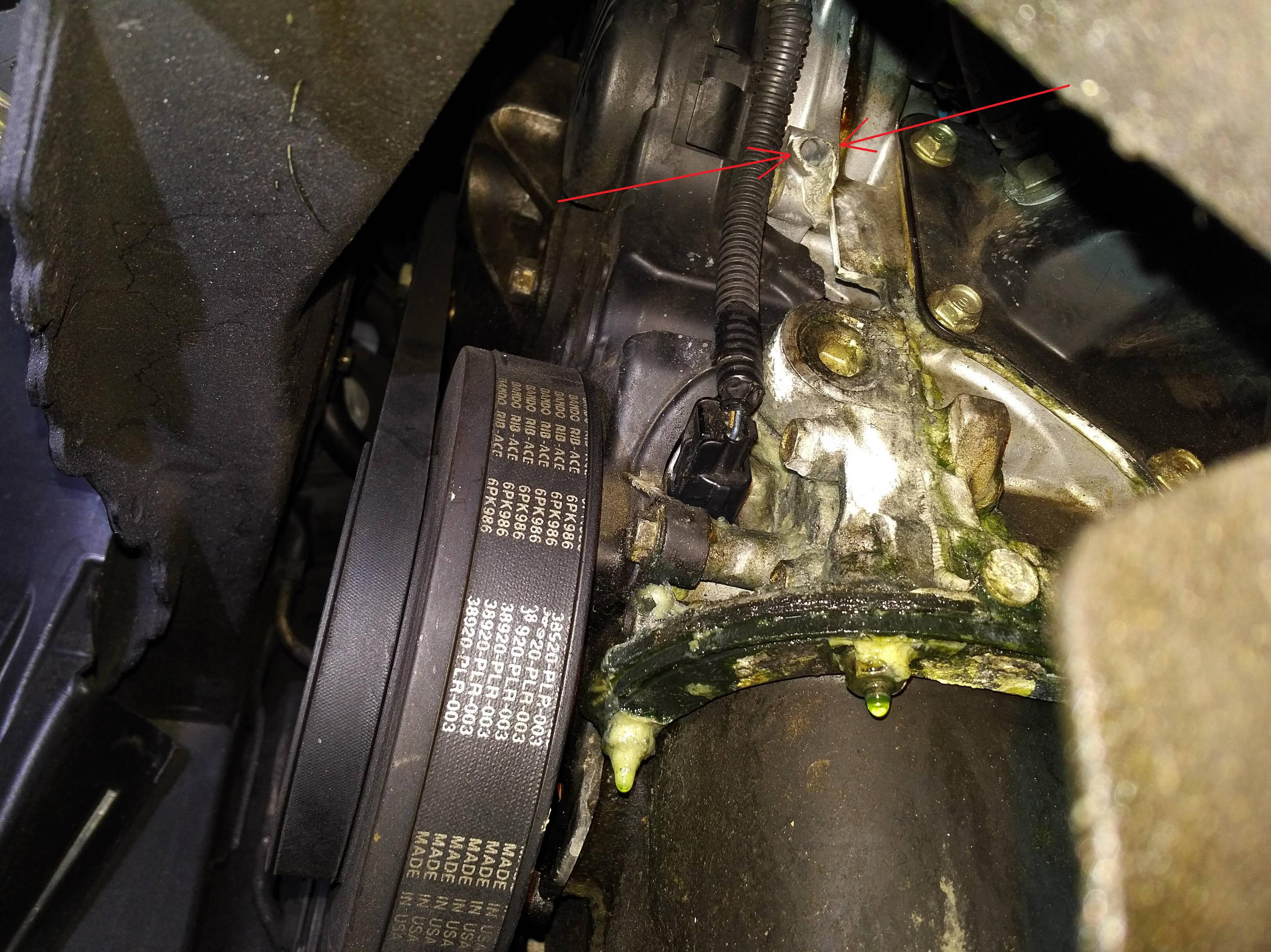

Re: 2004 Civic LX Coolant Leak *New Head + HC*
It really looks like its coming from the oil pan gasket. Any ideas? It's really pouring out
The oil pan cannot leak antifreeze.
The water pump is directly above that mess.
Looks like the mess probably starts at the pump weep hole (red arrows) there looks to be a trail of evidence that begins at that hole.
Aftermarket pump is bad? Bad gasket?
Time for teardown?

You might pull the air breather off of the throttle body and make sure nothing up there is leaking antifreeze (IAC valve hoses?), but from the pic I'd bet on the water pump.
Time for teardown?
Factory pump that doesn't like green coolant? IDK.
I appreciate you getting back to me. I contacted the guy who did the gasket and he is "100% sure it's not that". But who knows. Water pump has about 2000 miles on it but it's aftermarket so you might be right. I'll get some more info and post. Thanks again
Okay took it back to him. He pressure tested it and says it appears to be the water pump. Which is strange because it was just replaced. According to him he says when you blow a head gasket and your car over heats it can do a number on the water pump. I don't know how accurate that is, but at least he is doing the labor for free and just charging me for the pump. I'll update again once I get her back.
Huh?
How long ago was this water pump replaced? What was the warranty on that work?
Is it one of those lifetime warranty parts?
I'd put a Honda pump in.
Flush out all the green antifreeze while the pump is out.
Refill with Hondas Type 2 coolant.

Old Feb 22, 2016
Delbudge's Avatar
Posts: 6
Delbudge is an unknown quantity at this point
So looks like it was the water pump after all. Not sure if it was tied to the coolant, or the over heat from the HG, but swapped in a new one and nothing is dripping anymore. Also replaced the rad cap. Mechanic just charged us 45 for the new pump and all is good. Thanks for all your help fellas.
