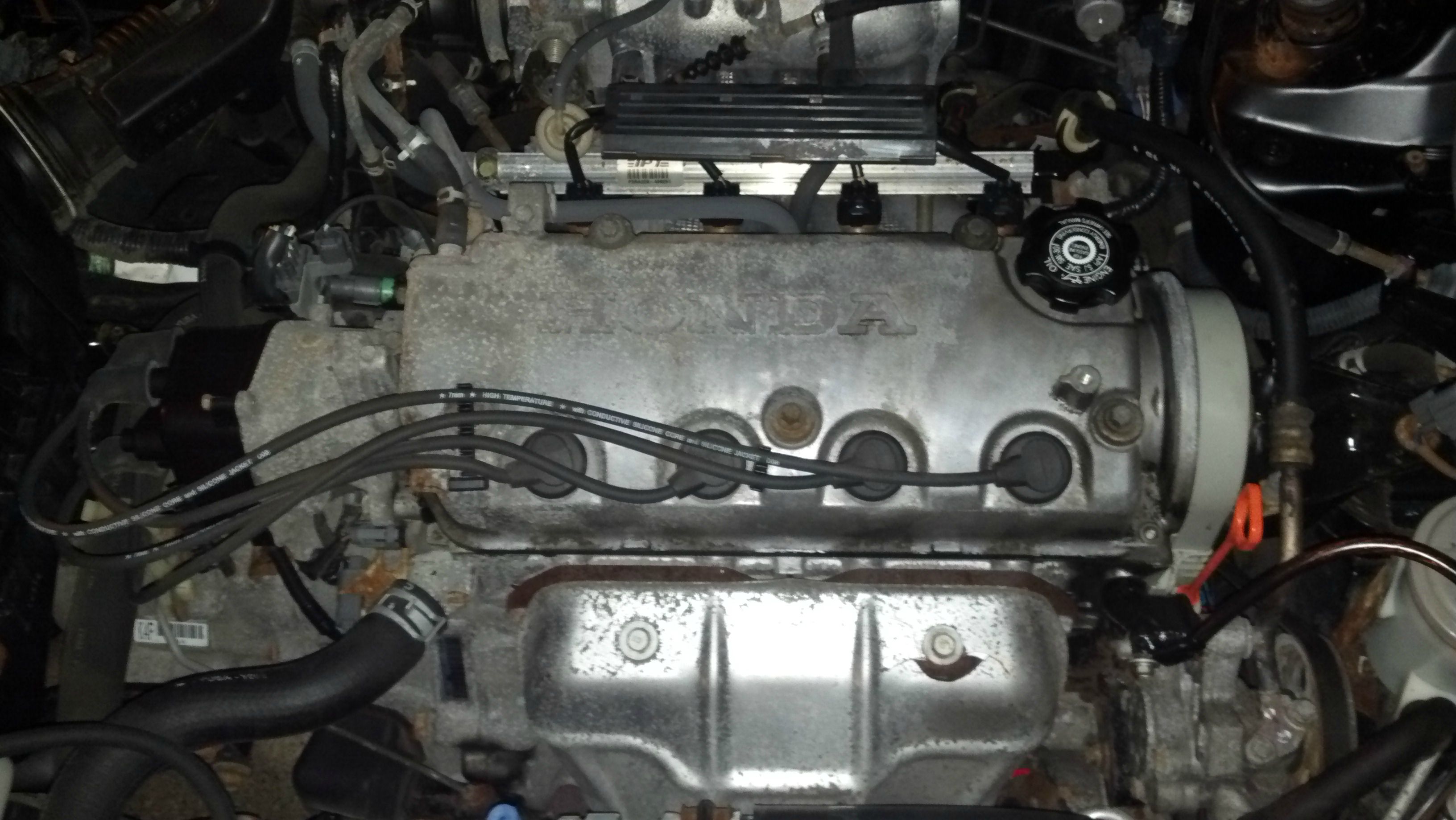

someone tell me what i got
according to the ex emblem on the back its an ex...but i dont think vtec engages and the valve cover just says "honda" instead of "VTEC honda"

EX comes with a VTEC motor.

i know they do but im tryin to figure out if the prev owner swapped a non vtec engine for some reason. is that a vtec solenoid in the pic?? if it is anyone know why vtec wont engage?

That is the solenoid though. Why it doesn't engage could be a number of things. I don't know them off the top right now. The screen of the solenoid could be dirty. I believe there's a DIY floating around here.

yes, that is the solenoid. It would not be bolted in there if not vtec head (no holes for bolts, i believe).
valve cover were interchangeable, i do believe.

maybe its because its a stock SOHC??? you wont feel much if anything at all and with a stock intake and exhaust you wont hear anything as well, also EX's in canada came with d16y7's only
check the motor stamp d16y7 = sohc non-vtec / d16y8 = sohc vtec
but that is the vtec solenoid so my money is on its working but it being a sohc you wont feel a thing
if it wasnt working you would have a CEL.

My valve cover only says honda to..I agree that the V-tech is kicking in but you can't really tell..No code means its safe to asume that its working.. Do you have an Auto or Manual tranny?

92-95 civics that came with vtec motors, d16z6 have vtec on the valve cover 96-00 d16y8's only say honda except for canadian acura 1.6 EL's they also say vtec
