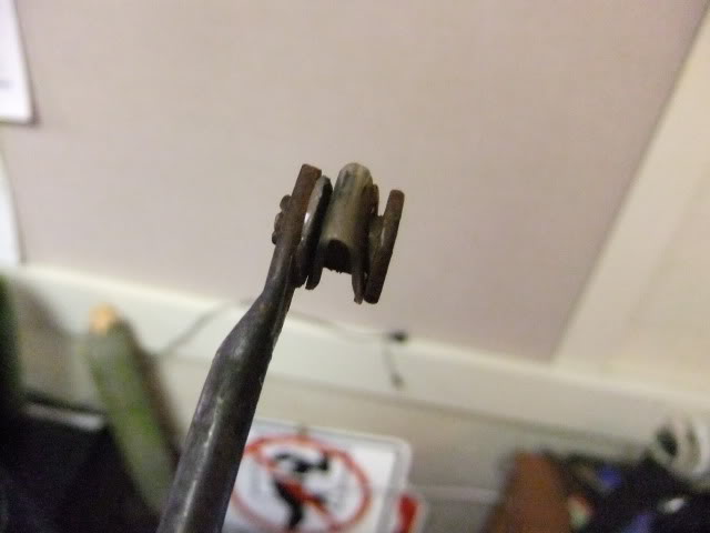

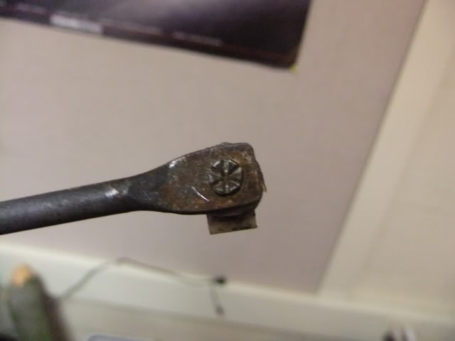

Took out my passenger side door actuator today..well, in more than one piece. I read up on gearbox's DIY and though it was (extremely) helpful, I was unable to take this part off: (I had to cut the metal to get it out and unscrew it) Now what I'm wondering.. how on earth are you supposed to get this damn piece off so I can put it on the new actuator?

Looks like a rivet, you cant take it off.... I doubt
and what the hell is that from?
I never saw anything like that from the driver side door taking apart my actuator
Are you replacing the actuator? or the entire door lock assembly?

i just replaced that part on my 02 civic yesterday and it took 5 mins. take a few screws out, the window channel, and the rods, then it just comes out. im not sure why you are messing with the handle at all. you just need to replace that part above. altho judging by your first pic, it looks like you broke the door handle where the rod connects. that clip can be a pain to squeeze out the rod, but a pair of wide nose pliars did the job for me. you made a big mistake cutting that off and now you need a whole new door handle too. the rod shouldve been able to squeeze out of that plastic clip.

No I didn't break that part of the door handle it actually just screwed out. The new actuator/door locking mechanism comes with a new one so I can screw it back in when I get the new one (that's why I thought I had to take the whole thing out in the first place). But yeah overall I realized I shouldn't have taken the whole damn thing out. Ah well, I seem to always learn stuff the hard way first.
