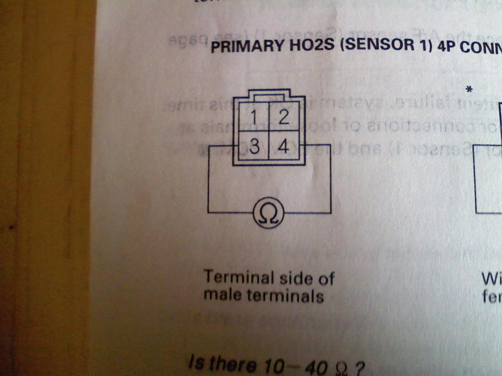

How to check a P0135 code (part 1):
Tools needed: Multimeter
1. With the ignition off, disconnect the primary HO2S (sensor 1) 4P connector. This is the one below the engine.
2. At the primary HO2S side, measure resistance between terminals 3 and 4:
Is there between 10-40 ohms?
YES- Go to step 3
NO- Replace the primary HO2S

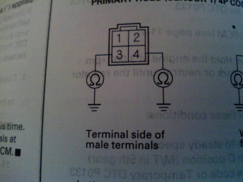

3. Check for continuity between body ground and terminals 3 and 4 individually:
Is there continuity?
YES- Replace the primary HO2S
NO- Go to step 4

^the O2 sensors read voltage as a signal for the O2. If the sensor was spliced in with crappy connections or soldered, it could create low voltage. I would jack the car up and take a look- make sure they are OEM style, where they have pigtails off the sensor that go to a connector and go up towards your engine bay. Also make sure they are screwed in correctly. Simply turning the sensor 180 degrees in the pipe may fix your problem. Also pull your battery cable while your doing this so it resets the ECU. Then do a ECU reset once your done by having all electronics off, and turning the car on and letting it idle for 10 minutes, turn off engine completely, and then restart and drive. Everything should be fixed, if not, go to autozone and get that CEL checked.
