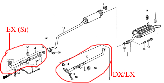

WOW there's some bad information in this thread. The headers from a American EX will fit a Canadian Si. The LX and DX headers are slightly different from the Si (EX) counterparts. They will bolt on to the head, but you will need a exhaust shop to modify your B pipe to get them to match up if you want to use them on your Si.

Yes the EX (Canadian Si) headers will bolt onto the car. You need to have your b-pipe modified. You will either need to get a muffler shop to extend your DX's b-pipe, or get a full EX (Si) exhaust. Notice on the attached image, the length of the b-pipe (circled for each model) is different, as well as the angle.
