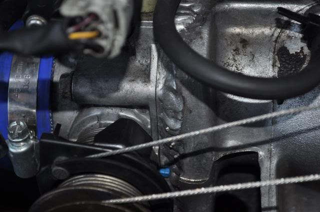

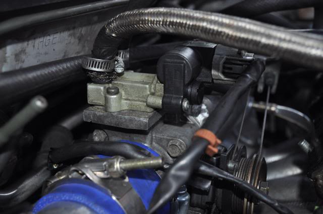

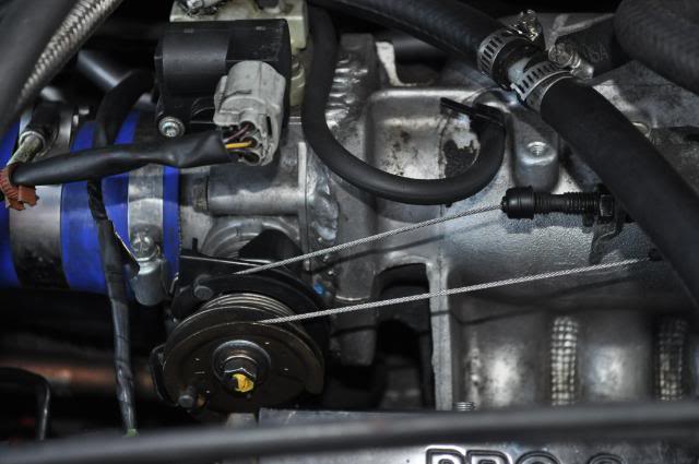

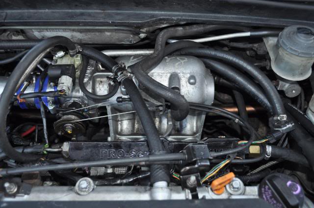

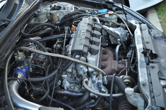

I've done this swap.... D16Y8 on the D17... Im using a Golden Eagle Fuel Rail, Return Fuel Setup, and welded on a D17 TB Flange. So I am still running the Stock TB. I have pix and a half *** walk through on 7thgen!

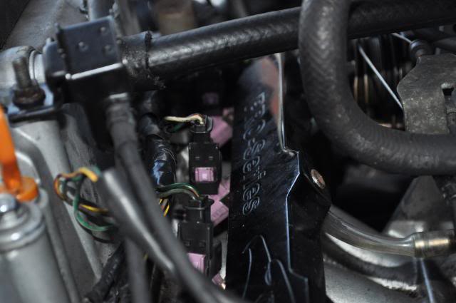

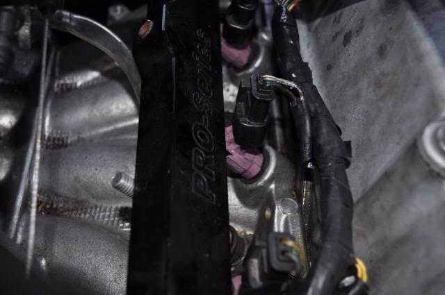

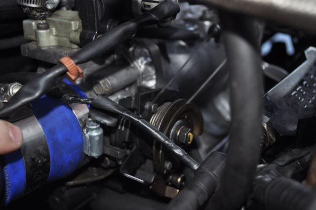

Fuel Pressure Gauge.

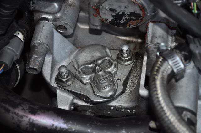

EGR BLOCK OFF PLATE
These are some pic i just ran outside and took!

See, DJ knows how the big boys roll with that awesome throttle body adapter plate

Yeah I looked into doing this swap a few months ago. knife edged my throttle plate and the car ran like SHEET! replaced the whole throttle body with one from an 03 at the yard and it ran perfectly. Lesson learned: messing with the intake system too much will cause the car to run bad. Im not even going to attempt this swap until i get K-Pro. Which will hopefully be soon

Re: d16y8 Intake Manifold
@Djarmyssg did the d16y8 bracket for mounting the bottom of the manifold to the block fit on your engine? And what kind of injectors are you running?
Those are stage 0 srt-4 injectors (unless I'm wrong somehow). That manifold support brace is totally useless and unnecessary.
Baron hit the nail on the head.. Bracket is TOTALLY useless!! And Yuppers. Those are SRT-4 Stage 0.. But im running 58PSI of fuel pressure, which makes the injectors 588cc If my memory serves me. But imma bump up to 80PSI and make them work at 690cc!!!

So many tubes all over your engine bay! lol. Sounds like your kicking some serious *** with that thing.
