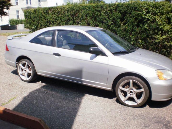

antifreezee is fine and the coolan level is ok and yes my car has white smoke coming out of the pipe what i see the other day too is the antifreeze is not circulating through the engine and with the radiator cap open and the engine on i see some bubbles coming from inside the radiator
BTW there is picture of my car
