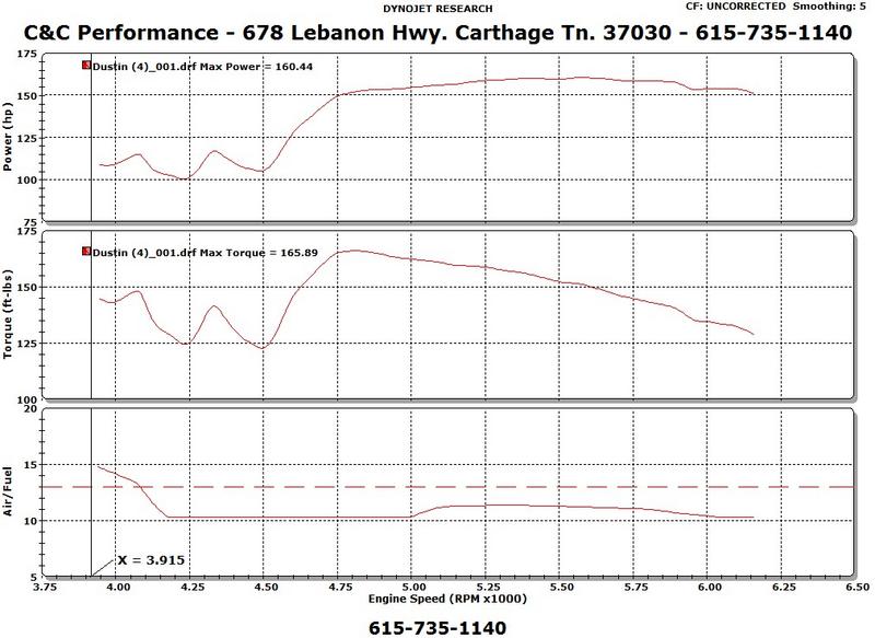

here is my dyno run.. the "proof"

to O1civic coupe: Like I said before I wasn't hating I just wanted to see some charts. 160.44 hp and 165.89 tq is not bad! but its not 187hp and 197tq and there is a bunch of people out there that have struggled to hit those numbers with just a turbo kit. and that is why I was sceptical. Actually I know the shop you got it done at they supposedly do really good work.
but anyways good numbers and nice job
Shut Up Edwin LMAO!!! Justin is so confused on how you hit those numbers lol. I know your running pig rich too your hitting those numbers with those af I know there is at least another 20hp if not 30 if you would just take it up to Jeff and lean it out a bit. I'm glad to see your still messing with the vic from time to time.
for those of you that don't know Jeff Evans I would rank some where as on of the top three honda tuners in the country. The other 2 being Ben from hondata and then there is one guy out in colorado that created the T1 cam trigger for the b and d-series motors, andyman97 knows him. they don't really get better than those three

thanx bro i appreciate that now its time for kpro and a cam.. do u recomend the stage 3 with boost or should i just go for the stage 2 boost cam?? The shop i go to is pretty good they do good work. theyre justgettin into hondas but the tuner there is good

I will always love the stage 3 cause it is butter smooth, but it is one of those cams that you are going to need enough static compression to really see results. I say go with the stage 3 if you are going to try to push more than 14 lbs of boost if you are only trying to hit like say 7lbs I say go with the stage 2. The cams seem to be the secret with these engines it allows you to make so much more power easier.
So I say if you are shooting for big boost with forged internals or want a really smooth ride go with the stage 3 if your are just trying to make the most of low boost go with the stage 2

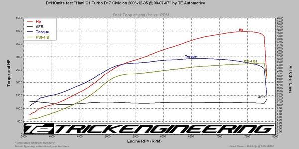

i have 2 second that lol i put down 390 at 25 psi on my d17a2 and let me tell u picky isnt teh word lol.....as long as u have a good tuner with patience ur all good lol

dyno sheet with mod list nao
Old Apr 21, 2009
  #43
boostnut87's Avatar
Joined: Apr 2009
Posts: 32
boostnut87 is an unknown quantity at this point
Re: D17a2 Dyno results

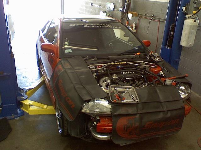

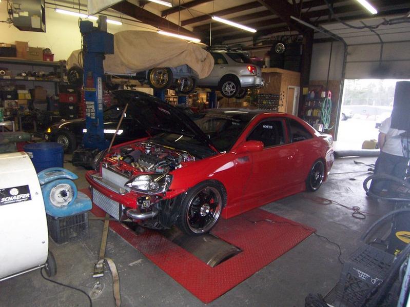

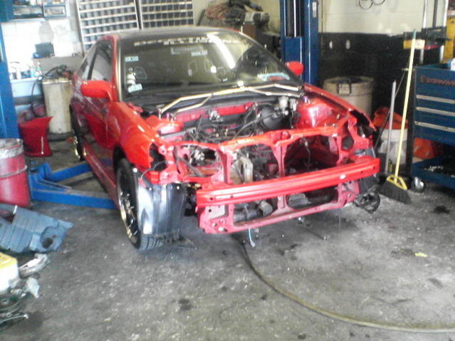

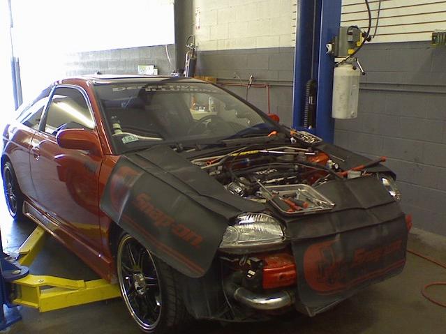

In Car ElEngine:
-d17 motor 9:0:1
-crower rods
-crower stage 2 turbo cam
-crower springs nd retainers
- weiseco pistons
-Darton sleeves
-garrett t3t4 turbo
-HKS bov
-Tial wastegate
-Mroso oil catch tank
-Trick Engineering custom turbo piping
-Trick Engineering custom down pipe
-Trick Engineering custom turbo manifold
-Venom fuel rail
-Venom intake manifold
-Power 68mm throttle body
-RC750cc injectors
-Walboro intake fuel pump
-Vibrant intercooler
-Koyo radiator
-AEM ems
-B&G fuel pressure regulator
-Edlebrock fittings

Nice! but I wouldn't have sleeved
