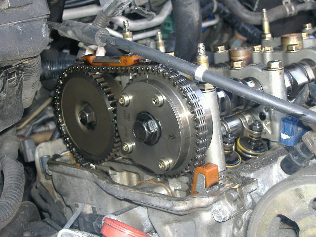

ok guys i took the valve cover off and really didn't see anything out of the ordinary....heres some pics

more pics...i really think the problem is in the bottom end

put your motor at TDC... the lift each rocker to see the gap between the rocker and the cam... if theres a big gap then you got a problem.. or if you want to go to auto zone and get a feeler gauge

u need to take a closer look of each one..
like this..........
inspect each of theose screws with those flat head slots on top.. make sure there all the same length.. and none of them are loose.. if not just take closer pics of each lobe both intake and exhaust side

i checked those screws like u said "x" and there all tight and all..i also started it again to see if i can hear and feel for the tapping and i still think its the head somewhere...well anyways its goin to a performance shop tomorrow and if its a lot of damage im just gonna do a k24/20 swap

Yeah thats a bad sound. If you dropped a valve you'd have lunched the motor entirely. Most likely its probably from motor being run low on oil. It doesnt take much to smoke a k20 top end. More than a 1/2 quart low at 8000rpms+ can make em sound like that. The top end is the first to go, starts with valve guides and goes from there. Once a guide wears it lets the valve move all over the place and more damage is done. Not to mention that if there is slop, that means more clearance, lower oil pressure and progressively more problems. I bet if you do a compression test you'll find a #3 or #4 cyl is reading low. It would only be a lower end rap if you had extreme detonation or like 1.5+ quarts low, but most likely you'd lock up the motor before you pounded the bearings out at that point. A broken ring land or two dont usually make much harsh noise, generally the engine just runs lumpy as all hell if its running. You are looking at spending some cashola to get rid of that noise. K20 = $$$$$$ Let us know how you make out. I think its in the head, probably a bent valve but its hard to tell from a video.
