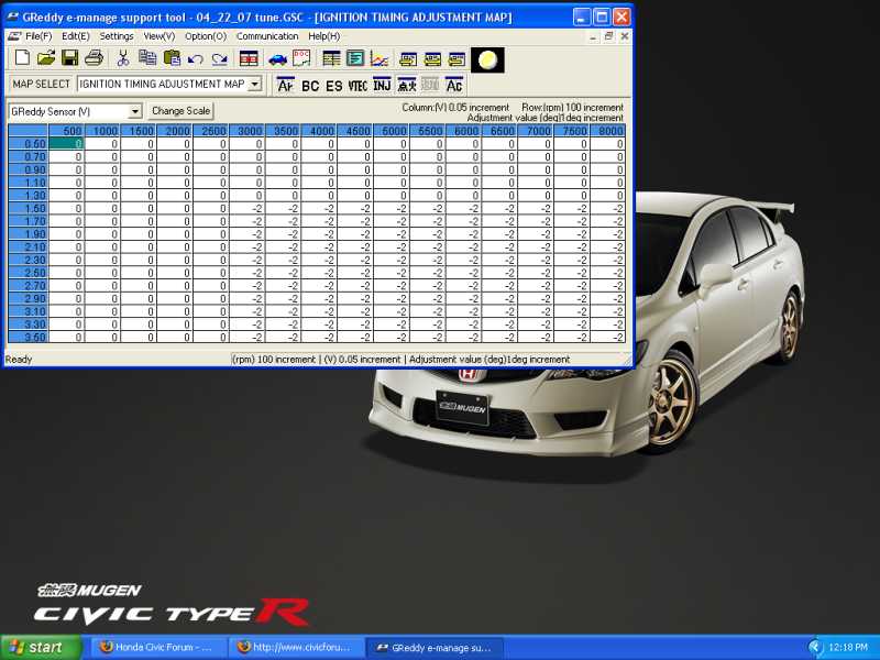

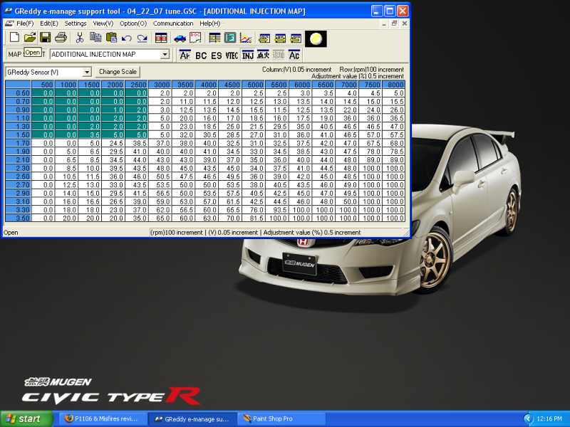

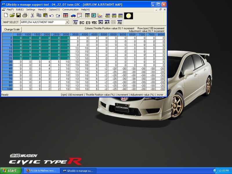

ok, here's my emanage maps....on 7 psi......tnaff's base map used for tuning. I am using 270-310 injector correction.

I ALREADY SEE A PROBLEM. You have no ignition timing. Plus you should only be minimally using the airflow map to pull fuel. Use the injector map to add fuel.

Well, I'm just getting my feet wet. I would imagine it would be very difficult to tune ignition...where would I begin?

I added my ignition map as a reference

ohh and im using 240-310 correction also

Wow, thanks alot! How do you work around tuning that ignition map? Should I just start with what you got & see how she runs huh?
I think I'll change my inj. correction to what you use, fill in my ignition map out, & test drive. See if she blows up. I know it's gonna be alot of trial & error.
As regards to the air/flow at low end.........I suppose I'll just need to trial & error that aswell.
I do appreicate all the help, there is just not alot of info out there or people for that matter who know alot. My tuner doesn't even wanna mess with it again until I get hondata, so I suppose I'm the tuner now
So, I'm getting my base in emanage......so airflow is only for subtracting and injector control is only for adding correct?

i would focus on the 3,000 rpm and down tune. as thats where most of your driveability is going to be found. and is the hardest to tune for. Ideally you want to use a scanner to watch your short term/long term fuel trim.
think of it this way say you go for a drive and the second you hit cruise speed you notice that your to lean. So you add fuel and if you added to much the computer will compensate for it. BUT when you come down off that cruise speed its still taking fuel away. SOOOOO you just came down from a cruise speed and at a stop light and all the sudden your car is about to die because your bouncing around 16-18:1 AFR. What this tells you is that you added too much fuel at cruise speed and the computer compensated and adjusted the long term fuel trim taking out fuel. Then when you came back down to a stop the computer is STILL pulling fuel out until it re-figures 14.7:1 ratio. So with out a scanner you cant watch these trims. and the guessing game comes to play. This is why e-manage has got such a bad rap. It's because most people dont take the time to tune it properly.
