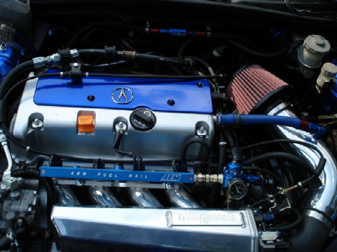

I want to thank everyone who helped me and gave me info on this swap! Car fired yesterday and is heading to maryland on friday to get tuned. Also please let me know what you think. Thanks again guys!!!!! When it is back from paint I will post more pictures of the whole car and other custom mods.

That's a clean swap.
Nice intake manifold!
how does it run?

It runs too rich basically my tuner said just to get a base map into the ecu and he would take care of the rest. Thanks for the props it took me a long time paying attention to detail. I polished the rack and the tie rods to waiting for the motor to come back from machine shop. When it gets back from the tuner I will post more pictures. Thanks for the rep guys!!!!!

and what prevented it from starting?

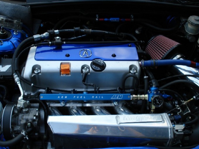

Its a magnus intake manifold. I talked to marco at magnus and he made a manifold to go with my swap

Well I pluged the two connectors into the jumper and eliminated the E connector part of the jumper harness and went straight into the ecu with that connector and it fired right up.

marco at magnus made this intake manifold specially for my swap.

I bet the reason it did not start was because you plugged in the E connector to the Jumper harness then to the ECU.
Thats probably what stopped it from working.

Thanks for everything bro!!!! and exactly what you said. I plugged the E connector straight into the ecu and it fired up. Thanks for everything! Maybe when the car is do I will burn up your way.
