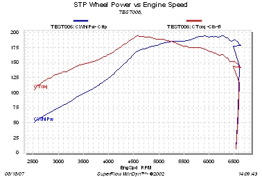

Dynoed The Civic Today For The 1st Time .
The Numbers Came In At 194/194 Good Start.
What Do You Guys Think..

Sorry , For The Graph To Be So Small, But Im Working On Getting A Bigger One Posted .

that torque number seems nice to be matched up with the hp...thats awesome..post some cooler videos..some drive bys or u in the car messing around.. i would.. hows that VC holdin up with the paint and all..anything else planned?

I WAS PLEASED WITH THE T25 TURBO . THE NUMBERS ARE GREAT FOR WHAT WAS DONE. THIS WINTER THE MOTOR WILL COME OUT,AND WILL
INSTALL PISTONS,RODS,AND SLEEVES. AND GO WITH DEZODS TURBO KIT.
SHOOTING NEXT FOR 350 HORSE POWER.

After all the headaches you've been through I'm happy to hear you are tuned and running. The hp numbers I don't care so much but the tq is insane from that t25. 11 psi is up there though... are you running that much daily? Just curious. Have fun being boosted though. I'm jealous.

Small turbos spool fast. Fast spooling is a early onset of power. Power below 5250 RPMS = TQ. So small turbos typically produce more TQ than HP.

Because that T25 is taking him about as far as it can go. Sure the T25 has a few more PSI in it, but not enough for 350whp. That is where our kit and turbos come into play. More boost on less power.
