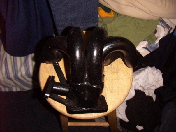

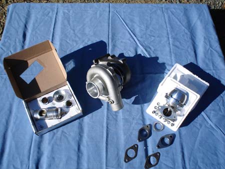

Okay i just want to check that i have everythign i need to boost my D17 Non-Vtec in my 05 vic.
Heres my stuff
1. T3 cold = .42, hot = .48

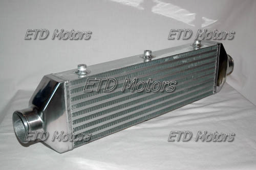

2. FMIC measures 27x6x2.5
3. FMIC piping - 2.5" piping
4. Greddy Emanage - got it for 500$US already dyno tuned for 6/8/10 psi with pnp harness and everything.
5. Turbo Manifold - picture is on bottom of post
6. RSX-S Injectors - got em for 80$US
7. RFL BOV
8. WG - 35mm ajust from 3-20 psi
ummm i think thats everything, i dont think i need a missing link or anything, lemme know.

You still need gauges, oil lines/fittings, vacuum manifold (optional), downpipe, dumptube (optional if external wastegate), and custom exhaust to mate up to downpipe.

Looks like an ebay special.... start saving for some real parts,. and you got ripped off on the emanage, because it can only hold one map at a time, not 3, and you'll have to retune it to your car anyways.

Thats sure as hell doesnt look like a garrett snail to me...

and no ur right, its not a garrett shell, but the internals are garrett i beleive

I've never seen a garrett turbo without garrett housings. its either a garrett. or some putz blew up a taiwan Inc turbo and had garrett guts put in it afterwards, but then it wouldnt look new.

I wanna start by thanking everyone who helped me so far with this... secondly i wanna say i kinda went a different route..... bought a new turbo, rfl BOV and external w/g.... now the question i have is the FMIC i bought measures 28x8x3.5, now i pretty sure the 28x8 will work since the dezod kit measures 26x9 or something like that, the part im ceoncrned with is the 3.5" think.... is thier much room thier? i havent removed my bumper yet....
Old Mar 22, 2007
andyman97's Avatar
Turbo Guru
Posts: 4,078
From: Rockville, MD
Rep Power: 351
Re: Double Checking my Turbo Set Up...
You can make it work.

gonna have to do some trimming of the front bumper dude....
