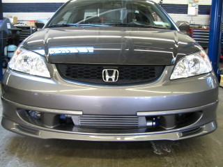

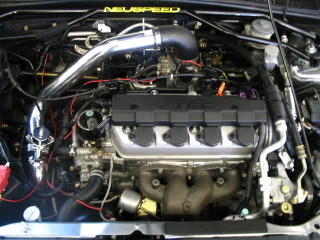

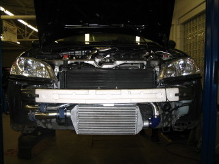

HERE ARE SOME MORE PICS OF THE PROGRESS ON THE VEHICLE .
STILL HAVING OIL LEAK PROBLEMS. BUT THE PIPING FOR THE INTERCOOLER
IS DONE. CK OUT AND SEE THE PICS . HOPE TO HAVE MORE VERY SOON. THANKS.

Cured My Dam Oil Leak , Its About Dam Time. Modified Bumper Alittle.modified The Radiator Support To Fit The Plumbing For
Turbo Pipes To Intercooler. Let Run , Having A Idle Problem And
Code P0507 Idle Control System Rpm Higher Than Expected .
Ajusted The Tps To .50 Volts And Adjusted The Idle Screw.
Completed The Idle Learn Procedure. And Have The Idle To 800 Rpms .
On Accel The Rpms Go Up And The Rpms Come To 1500 Rpms And Back Down To 800. Seems To Be Hanging Up Or Or Something. If Any One Has Ideas Please Leave Here. Thank You. ( Almost Done) .
Also Hooking My Vac. Hose To The Tsi Control Unit And The Blow Off Valve. It Does Not Show Any Boost. I Have A Extra Boost Gauge Wounding Were To Tap Into To Get The Correct Boost Reading. Any Info Would Be Helpfull.
