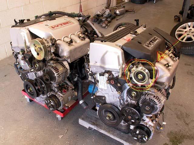

You DO NOT need an SI ecu. It does not have anything to do with the power steering. The EPS system should come with a harnass and control box that will make it work. The power steering pump and pulley on the K20a or k20a2 motor will need to be replaced with an SI Idler pulley set up. Shown below. Brand new, the idler pulley should cost around 80-100 bucks. roughly. I got my eps system for 400.
