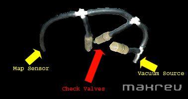

hmmm...thanks dewd...think i get what you are trying to tell...just found a pic which is close to the discription you have given...but dont you think that boost will be leaking from these check valves?? (check valves are basically one way pressure release valve right??)

no, that isn't how they work, the holes are so small, they just don't allow the map sensor to see anything above atmosphere

^^^i thought that this was how the check valves are setup
