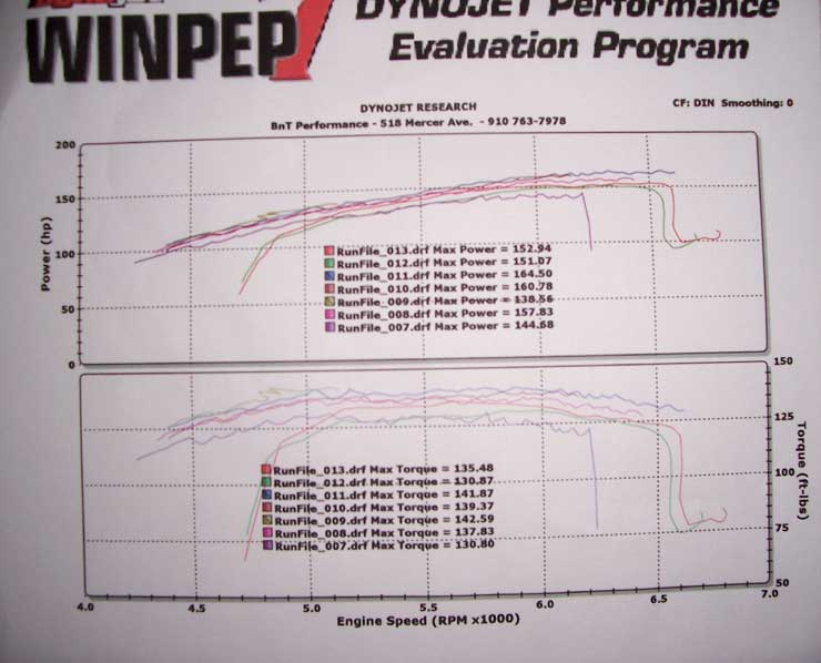

Ok, first and foremost I would like to thank all of Team Dezod who was involved with making this V3 happen (you know who you are!) and Chris from 7thgen for being excellent on some feedback & essential components.
Just to recap, back on our D17 EX Auto bone stock was 90whp & 85wtq. After our V1 kit @ 8.5 PSI, we hit 147whp & 122wtq. Just to refresh everyones memory.
V2, no auto guys stepped up to the plate to help out with dyno figures, but the 5 speed guys stepped up BIG TIME! (I won't get into it; just to keep apples to apples)
V3, now this is a different ball game. This kit is in a league all of it's own. The kit was REALLY re-engineered in almost it's entirety. It had improved manifold design, improved downpipe design, improved intercooler design, new oil drain system, better turbo with NEW Garrett wheels and the possibility of the new PCS XFC Piggy Back unit to help ride partial throttle trims like a standalone and a different charge pipe design.
Onto the dyno results for Chris. Ladies and gentleman, I present to you the HIGHEST AUTOMATIC HP 7THGEN IN THE WORLD ON 5 PSI.....
Chris's numbers are the following while tuning:
149whp & 131wtq--5 PSI
157whp & 137whp--5 PSI
160whp & 139wtq--5 PSI
164whp & 142wtq--5 PSI
V1: 147whp & 122wtq--8 PSI
V3: 164whp & 142wtq--5 PSI

So that means a manual would get something like 180ish to the wheels and possibly 200 with higher boost. I hope Chris let's us know if there are any kinks with the fuel management you know how ppl had all the issues with emanage.

Yeah 5 speeds can expect 10-20% more power.

Very nice #'s for 5 psi.
Dezod, you definately did your homework.

put up a pdf of the dyno graph.
lemme see

graphs graphs graphs.
