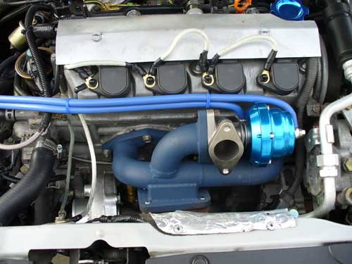

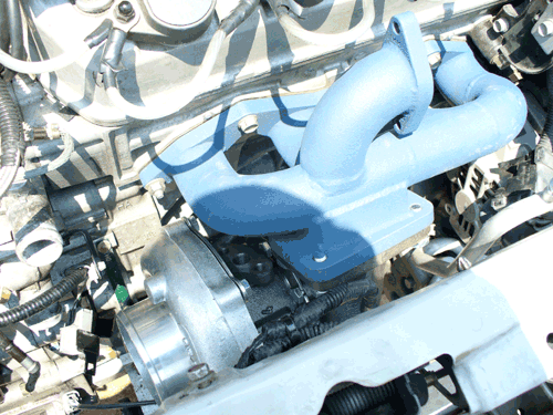

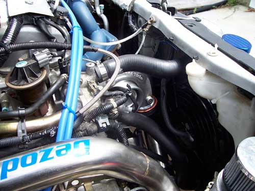

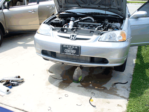

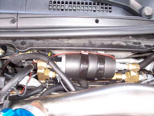

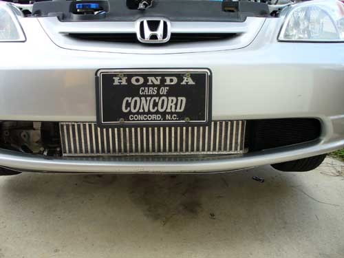

here are the final pics of the engine bay install. I got more pics coming later tonight or tomorrow.....

Originally Posted by WilmncChris
Hey guys, I have been working on the install of the V3 kit. So far the its been smooth sailing. No big Problems at all. I made life abit easier I removed the radiator so I am not jamming my hands all day long. As of this point I got the intercooler mounted and all piping is done. BOV and wastegate are on. I dropped the oil pan and will tap the pan tomorrow. I also have the RSX injectors in, but i will be machining some thread extenders so that the fuel rail can bolt down. Hops I did not miss anything kinda tired been a long two days. I will post some pics as soon as I get time. Paul at Dezod put some pics on thier site under 7thgen turbo kits. Hope you like.
Here are some of your pics.

here are some updated pics
here are a few extra pics hope you like.
http://img91.imageshack.us/img91/6870/p10001552zs.jpg
http://img114.imageshack.us/img114/5055/p10001581ke.jpg

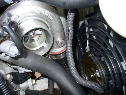

wow looks like a dam clean install. does the Turbo have a 90deg. welded on or are you using a 90deg. coupling?
The charge pipe has a 90deg. bend. Turbo outlet and coupler are straight. To get it to fit, u have to use a slimline fan.

You do not have to use a slim fan i just choose too. I am using 2 800CFM fans. On the stock fans you just have to cut out where the turbo and fan meet. But yes slim fans help out alot. I did not get much done today. I finished all the vacume lines, mounted the fuel booster, and started working on the XFC fuel system.
You sure about that? I couldn't fit mine (charge pipe) between the front motor mount and the stock fan shroud even when I trimmed the shroud.
