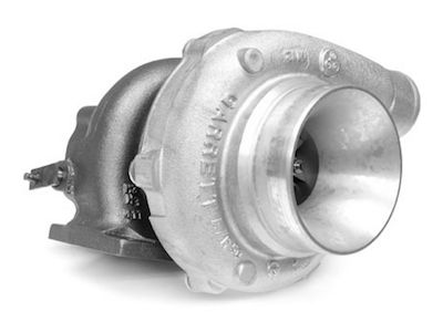

You should use the HKS manifold with this turbo
GT3071R-WG Dual BB, 86AR, 90 Trim Turbine
Based upon the same turbo as the HIGH flowing, larger framed GT3071R, but conveniently packaged into the same style turbine housing as the popular GT28Rs/GT2871R turbos. This turbo is uniquely configured with its own turbo wheel trim, turbine A/R, and compressor housing. Unlike, the GT28RS and GT2871R, this turbo now has a much larger compressor housing to support the much higher flowing 71mm compressor wheel. Comes with T25 style inlet flange.
Turbine
-Wheel: 56.5mm w/ 90 trim
-Housing: 0.86 a/r
-Internally Wastegated (No Actuator)
-Maps: Not Available
Compressor
-Wheel: 71mm w/ 56 trim
-Housing: .50 a/r
-Inlet: 4.00"

As far as that gt30, I'd stay away from it unless I was looking for big numbers. With the .86 ar hotside, it'll take forever to spool. Not the best turbo for the street.

I was being sarcastic jeeez. Is it just me or do you try to tear down what just about EVERYONE says. Anyone with half a clue would have realized that was a joke!
Ok, so I should have known that you were joking? Why would you suggest a turbo that is way out of efficiency to someone who's trying to pick out a turbo and manifold? I don't try tearing down what everyone says. But I don't think people who don't really know what they're talking about should be posting incorrect information. Sorry if you can't handle that.

Yes you should have known i was joking hence the smiley face after my text. I know very little and claim to know even less. Unlike some people! But i wont continue with the rant anymore.
