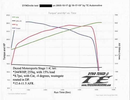

So when are we going to have the "official" #'s for the tc?
Now.

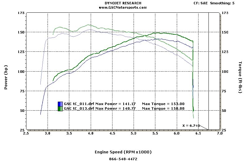

Very nice, so 140 is stock hp? thats a big gain.

Yup. This is a stock tC dyno and same car now with a DC header.

We averaged 11.8 WHP / PSI & roughly 11.7 WTQ / PSI.
Mind you:
Plumbed back dump tube
4 degrees of reatrded timing
11:1 conservative AFR
High flow cat on downpipe
This was also done a VERY low rating dyno in NH. He says about 15% lower than other places.

is this tc a 2.4l dohc?
the results of the turbo are nice 244whp!!nice tuning job
