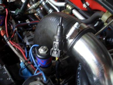

intake sensor
ok this is a pic of that sensor. what should i do with it? should i stick it in the intake pipe or is there a way to bypass it?
Yes, thats is the IAT sensor. The way i attached it was to use a die i THINK it was 11mm x 1.? and thread the out side of it( it worked perfect for me ) Then i got an 11mm nut. Drilled a hole about 5/16" - 8mm in the pipe close to that location and welded the nut to the out side of the pipe. Then thread the sensor in and plug it in. See picture below...
