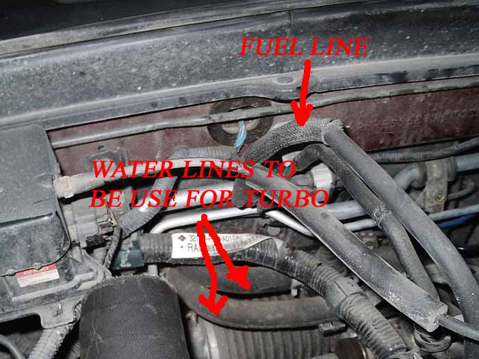

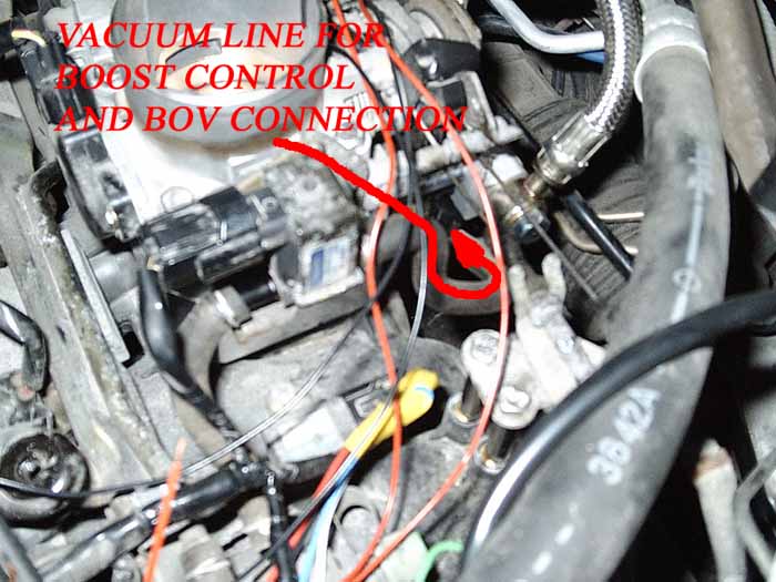

Question **EDIT** pics added, HELP to ID fuel line, water line & boost vacuum line
ANOTHER EDIT:
I'm currently installing TSI kit...
Please tell if my markings on the pics correct.
tell me if I'm right

it is a 15/16"
the fuel line is distinctive because it as a black connector on both sides with a green clip. You press the green clip in, then gently pull it off.

Originally Posted by turboengnr
it is a 15/16"
I think it should look like a tube comming out of firewall and leading towards intake manifold where it will be distributed accordingly...
U may be confused about fuel rail, to I just need fuel line to tap in tube connector for my additional tsi injectors.

You should only have one line going to the fuel rail. So just follow that one line back and that is you fuel line. Like turboengnr said its the one with the green clips on it. The line that runs alone the fuel rail (looks like it is made on to it) I think that is the fuel evaporator line or something like that.

Yep, it's the one with the green clip at the end of it...

main post updated with a pic, pls look and see if you can help

Originally Posted by 03-Acura-1.7-EL
EDIT: found picture from other member on this site
please look at the pic and tell me if this is fuel feed line (metal tube with gray clip above injector plug)
Please hepl me to locate fuel line...
I think it is made out of metal, going along injector connectors, then metal patr ends and begins as a robber hose, then at the firewall connects to the metal hose again and dissapers behind firewall. Is this it, or I'm wrong?
Do you guys know the nut size for oil pressure sensor? I'think its 23, but I'm not sure.
No, that is not your fuel line that is your vacumm line for idle control.
Then fuel line is right next to that other line by the fire wall.
Do you have a service manual?

edit, pls read first post

as for the water lines i used the lines from the throttle body heater lines there are perfect size. and i bought a eagle vacuum manifold and tapped in to the brake booster line , an dnot sure on the oil pressure sender ...

the line you have shown for the vaccum looks correct.
And that line you have looks to be the correct line for fuel. Just double check to make sure they have the black/green clips on them. The fuel line is the only line on the car with those clips.

Yep, I got it now, connected all lines yesterday. You were right on the wrench size...
Thanks for all your help!

I see the hose that you're illustrating in your pics for the vacuum hose. However, the tubes that I have and the 2 T-connectors are for hoses MUCH smaller than that one. I guess I'm just missing something. Any other suggestions?
I got an answer for you in your other post....
