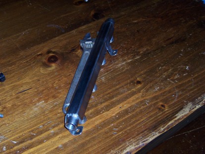

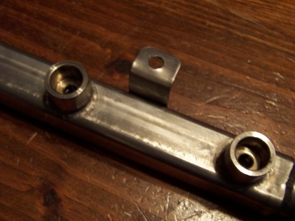

I have a stainless steel one on my counter right now. It will fit d17 injectors and rsx injectors. It has 2 ports so you can plug one off or make it a return setup. This one has never been used. I made one for my old manifold and it worked great. I have a d16y8 now though. I was gunna sell them but nobody wants them. I got RCs to fit using the factory o-rings. The injector ports are cnc machined. I have made a jig for these and have parts to make 8 more.
Old May 30, 2005
02fpcivic's Avatar
Posts: 1,222
From: Middleboro,MA
Rep Power: 298
02fpcivic is a glorious beacon of light02fpcivic is a glorious beacon of light02fpcivic is a glorious beacon of light02fpcivic is a glorious beacon of light02fpcivic is a glorious beacon of light02fpcivic is a glorious beacon of light02fpcivic is a glorious beacon of light
These will support about 600hp and will never rust, corrode, leak, or explode. They have been pressure tested to hold over 150 psi. They will adapt to your factory fuel lines with a supplied list of parts( for about $15) or you can cut off the fitting and use a 1/4 inch hose barb with a 3/8 npt end. I have a lot of experience in making high end car parts. I will let these go for 125 plus shipping, which is pretty much a non profit sale, because I have been sitting on the parts for 6+ months and have not been able to get them out the door. Later guys

If for some reason it doesnt fit for your setup ill split the shipping and modify it for no extra charge. I just need to get rid of the $750 in stock and machine work. I dont need to make money, just break even.
