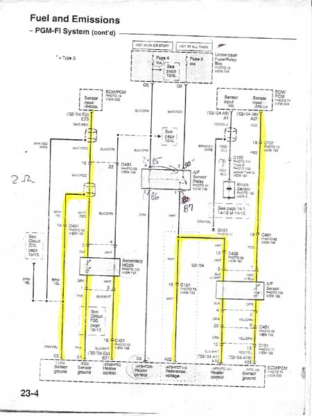

Anyone knows how to wire the DC5 O2s into the 7thgen. I have a LX with a DC5 motor, and I tried wiring this **** but to no luck. So far its running with no O2's but isn’t drivable because the ecu is throwing in so much fuel because the O2 aren’t wired. I have seen some stuff on here before about wiring the c101 harness (Already did that wiring) but it doesn’t say were to hook up the O2 to? Please Help.

To A Relay . Try Lookin On Hondatas Site. Theres Plenty Info Out There

I still don't get electrical diagrams very well. Can you tell me what wires you moved and were. Three are look strait forward but one sends to a relay. where is the relay?

The problem is wiring in the A/F sensor relay or as hondata calls it the O2 heater relay. Where is it? i have the O2 wired to the c101 but it still throws a primary O2 MIL.

Here is a diagram from Acura, for anyone elce that needs it.
