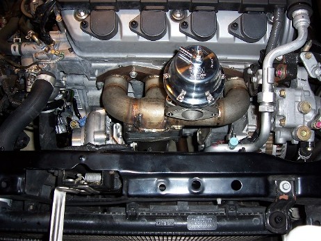

Manifold, turbo, down pipe, wastegate & dump tube assembly
First thing we recommend is taking turbo/manifold/downpipe/wastegate assembly, and making sure it mocks up correctly before turning any bolts down tight. We recommend turning them from 1/2 to 3/4 tight. The system is a very tight fit into the engine bay so be patient
Next we recommend clocking the turbo...it is important to make sure the center section has the oil feed and return straight up and down.
After you have mocked it up with the turbo clocked, we suggest you put the blue elbow for the oil feed and the bracket for the oil return on before everything goes in. We suggest using teflon tape on the blue fittings to prevent leaks....it makes your life very easy......
Now you are ready to put it in...it takes some muscle and strategic fitting methods to fit the assembly in. Do not try to put things in 1 at a time while in the car...it is much harder...WHEN BOLTING THE MANIFOLD/TURBO/DOWNPIPE/WASTEGATE TOGETHER IT IS VERY IMPORTANT THAT YOU DON'T TURN ANY BOLTS TIGHT UNTIL EVERYTHING IS PUT TOGETHER WITH LOOSE BOLTS TO ALLOW FOR SOME MOVEMENT...otherwise it may seem like your parts don't fit together...

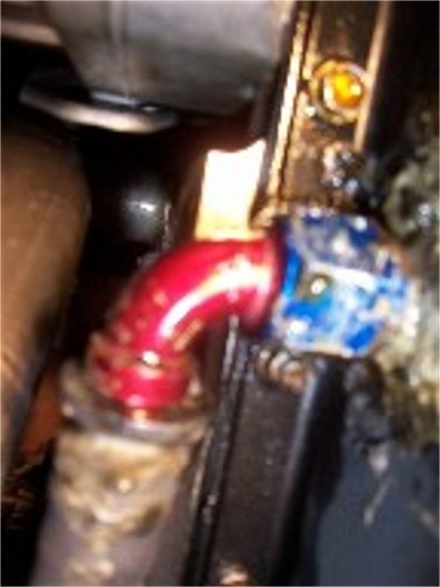

7. Oil Feed - After you put on your blue elbow with teflon tape and it is fitted down snugly, it is time to actually feed that turbo, but where do you find oil pressure for it???? If you look on the back of the block above where the oil filter goes, you will see a sensor, this is the oil pressure sending unit, which is what tells your car when you have too little oil and that pesky little red idiot light to turn on.....this is where you will get your oil for the feed line.
Using the supplied t-fitting you will remove the sending unit, (it is a good idea to unclip the sensor so no wires become damaged) and you will replace in its sport the t-fitting. In your kit you will see a fitting with two different thread types on it...one side goes into one of the t-fittings holes and the other screws into the feed line...the other t-fitting hole is occupied by the sending unit...it is also important to use teflon tape on these fittings as well to prevent leaks (picture 7)...now just screw on the braided feed line to each end with teflon tape and you're set...
Now the turbo is pressure fed by oil. We also recommend switching to a full synthetic oil like Amsoil, GTX....Also, we further recommend taking some oil and filling the reservoir of the turbo prior to starting the vehicle.

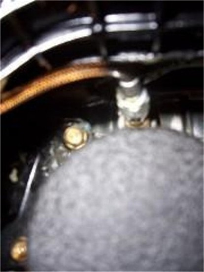

8. Oil Return - This part is kinda messy...it is gonna require taking off the oil pan...but before you do this...mock up how you want your return line to go. It is best to have a straight down drop to the pan with as little bends and turns as possible. Remember this is gravity fed, so try to make sure that there is no resistance in the routing of the line. Take a nice sharpie, mark on the pan where you want to have it drain...
Now taking off the pan...there is a metal bracket that covers the shallow end that needs to be removed...then it is just a matter of some small bolts to take off...very easy...after all the bolts are off...just wiggle the pan a little so it comes off..you want to keep the stock gasket...
Now is where a hole saw will also come in handy!!! In the kit you see a large bolt looking thing..but it has a hole in the middle, this goes in the pan. It is threaded, so with the hole saw cut it just a bit smaller than the piece and then thread it in or you can weld it...whichever you choose...
When putting the pan back on, we would suggest using a light dab of honda-bond or something similar to the corners of the stock gasket and putting it back onto the block...PUTTING THEM ON NINJA TIGHT WILL CAUSE LEAKS AND CAN ALSO STRIP THE BLOCK!!!

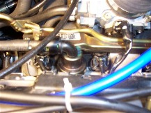

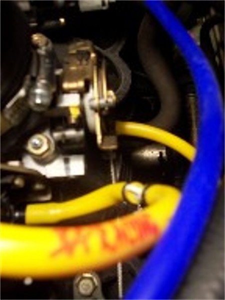

Vaccuum Lines - You're getting close to being done...don't get discouraged!
For the BOV you will need a vaccuum source that is after the throttle body. If you look on the back of the intake manifold (picture 10) you will see two that will be fine...either one works great. For the wastegate, you will need any source and route it to the bottom port of the wastegate, or if you have the boost controller....it is going to be to the solenoid for it...a golden eagle vaccuum thing would make everything look a lot cleaner and easier...
Electronics - The e-manage faq thread (see top of this thread for link) gives more information than necessary to install the e-manage and i do believe there is a thread on turbo timers too...only thing you will have to do for those is locate the ecu (open the glove compartment and pop off the cips on the side)

4. Let's Get to Some Good Stuff (manifold and turbo)- when looking at the kit that dezod supplies....you see 1 log manifold, 1 turbo, 1 dowpipe with wastegate dumptube merge, 1 beautiful Tial wastegate, and also 1 beautiful Tial blow off valve, hose fittings, oil T, line and return fittings, some gaskets, charge piping and intercooler, i opted to upgrade for the turbo timer, boost controller, e-manage and extra injectors....i also got the 2.5 inch high flow cat because i had a DX and converted to the EX exhaust setup where the catalytic converter is under the car rather than on the header...
...first thing to go in for me was the turbo/manifold/downpipe/wastegate assembly...it is always good to mock up how everything looks before turning any bolts down tight...it is a very tight fit into the engine bay so be patient....when clocking the turbo...it is important to make sure teh center section has teh oil feed and return straight up and down...after you have mocked it up with the turbo clocked i would suggest you put the blue elbow for the oil feed and the bracket for the oil return on before everything goes in...i would also suggest using teflon tape on the blue fittings to prevent leaks like i had....it makes your life very easy...i had to take my whole assembly out a couple times because of this
...now you are ready to put it in...it takes some muscle and strategic fitting methods to fit the assembly in..and don't try to put things in 1 at a time while in the car...it is much harder...WHEN BOLTING THE MANIFOLD/TURBO/DOWNPIPE/WASTEGATE TOGETHER IT IS VERY IMPORTANT THAT YOU DON'T TURN ANY BOLTS TIGHT UNTIL EVERYTHING IS PUT TOGETHER WITH LOOSE BOLTS TO ALLOW FOR SOME MOVEMENT...otherwise it will seem like your parts don't fit together...refer to picture 2 and 3
5. You're Moving Along Quite Nice (charge piping/intercooler) - next thing on your list is your charge piping/intercooler...if you take a look at your intercooler you will see that the endtanks are designed so that the air enters and exits on the same side...facing the car...it goes to the left (picture 4)...when you receive the kit it comes with a picture of how the charge piping goes...so once again...you mock it up...when i did mine...my intercooler piping actually stuck out too far into the wheel well...so i did what any do it yourselfer did and i modified (picture 5)...i used a hack saw and cut off a small piece of one of the pipes...no big deal...function over form
...on your charge piping you will see a v-band style flange for your BOV...very easy to put on...just remember the small brown o-ring goes between the the BOV and the flange...very important to remember...now you have your charge piping mocked up....time for your intercooler....on the top of it you will see a small, tapped post, ready for a bolt...with mine just sitting there...it sat too low...so i drilled a hole into the bottom of the bumper support to fit the post so it could bolt to the top of the bumper support....it is nice to have a friend hold your intercooler in the desired place while you sharpie in the drill spots (picture 6)...
now that you have it all bolted in...it is just a matter of tightening down your hoses..but make sure to use a wrench or ratchet instead of just a screwdriver..because they will pop off while in boost...and i'm sure everyone will want to boost more than the engine can handle once they feel it
6. Seems Pretty Easy With This DIY - by now your car is looking mighty fine....you might even be tempted to start it up...but do not....you need oil to the turbo...and some vaccuum lines hooked up
7. Oil Feed - after you put on your blue elbow with teflon tape and it is fitted down snugly...it is time to actually feed that turbo...but where do i find oil pressure for it? ...if you look on the back of the block above where the oil filter goes...you will see a sensor...this is the oil pressure sending unit...it is what tells your car when you have too little oil and that pesky little red light to turn on...this is where you will get your oil...using the supplies t-fitting you will remove the sending unit...it is a good idea to unclip the sensor so no wires become damaged...and you will replace in its sport the t-fitting...also in your kit you will see a fitting with two different thread types on it...one side goes into one of the t-fittings holes and the other screws into the feed line...the other t-fitting hole is occupied by the sending unit...it is also important to use teflon tape on these fittings as well to prevent leaks (picture 7)...now just screw on the braided feed line to each end with teflon tape and you're set...
8. Oil Return - this part is kinda messy...it is gonna require taking off the oil pan...but before you do this...mock up how you want your return line to go..it is best to have a straight down drop to the pan with as little bends and turns as possible...make a nice sharpie mark on the pan where you want to have it drain...
now taking off the pan...there is a metal bracket that covers teh shallow end that needs to be removed...then it is just a matter of some small bolts to take off...very easy...after all the bolts are off...just wiggle the pan a little so it comes off..you want to keep the stock gasket...now is where a hole saw will also come in handy...in the kit you see a large bolt looking thing..but it has a hole in the middle...this goes in the pan...it is threaded...so with the hole saw cut it just a bit smaller than the piece and then thread it in....or you can weld it...whichever you choose...i chose to thread it in and then use some JB weld to get any spots prone to leaking..not the best way..but it works damn it! (picture 8)
when putting the pan back on...i would suggest using a light dab of honda-bond or something similar to the corners of the stock gasket and putting it back onto the block...i believe the norm is to torque the bolts to 8 ft/lbs in a certain sequence..but i just gave mine a half turn past the threshold and gave it a twice over...PUTTING THEM ON NINJA TIGHT WILL CAUSE LEAKS AND CAN ALSO STRIP THE BLOCK!!!
Injectors - if you bought the RSX type S injectors...it is a very straight forward install...unhook all the fuel lines to the fuel rail and undo the nuts holding it to the block ...FUEL WILL SPILL/LEAK...now to remove the stock bolts because they're too short for the new injector size...you will need to use both of the nuts just taken off...screw them both down about half way and make sure they are tight to EACH OTHER...then screw the bottom one like you are taking it out...repeat the same for the other...i just went to home depot and matched thread for a longer bolt for the new ones...then remove the clips that hold the stockers in the fuel rail...remove the stock ones...replace with the new ones...put the clips back on....and clip the harness clips back on (picture 9)
Vaccuum Lines - you're getting close to being done...for the BOV you will need a vaccuum source that is after teh throttle body...if you look on the back of the intake manifold (picture 10) you will see two...either one works great...i chose the top one...for the wastegate you will need any source and route it to the bottom port of the wastegate...or if you have the boost controller....it is going to be otherwise...a golden eagle vaccuum thing would make everything look a lot cleaner...and make things a lot easier too
Electronics - the e-manage faq thread gives more information than necessary to install the e-manage and i do believe there is a thread on turbo timers too...only thing you will have to do for those is locate the ecu ( open teh glove compartment and pop off the cips on the side) and locate the wiring for the ignition (take off the steering column)
