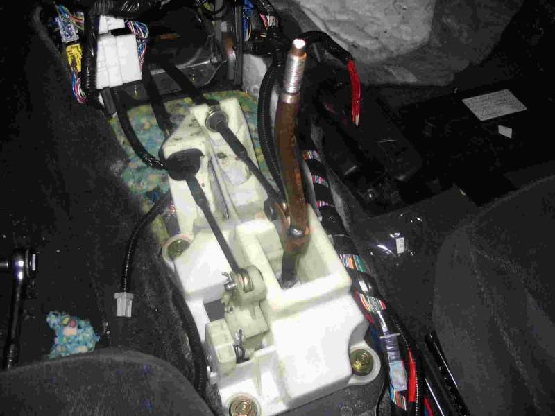

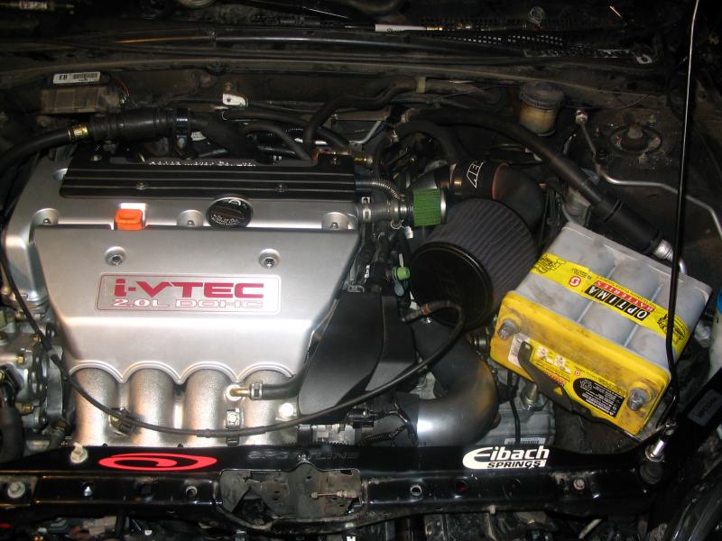

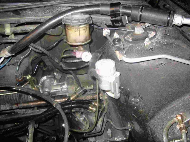

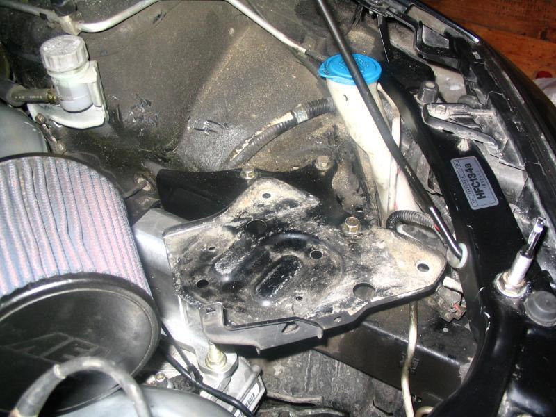

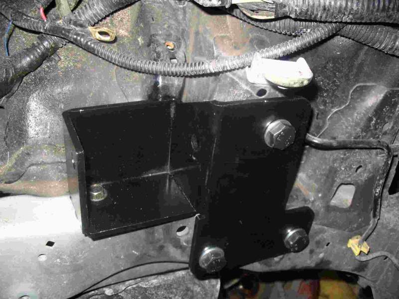

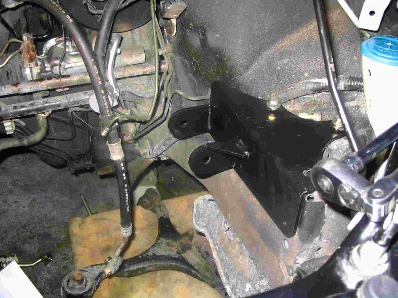

Well guys heres what i can get for now....
ID:	50183   Click image for larger version
ID:	50184   Click image for larger version
ID:	50185   Click image for larger version
ID:	50186   Click image for larger version

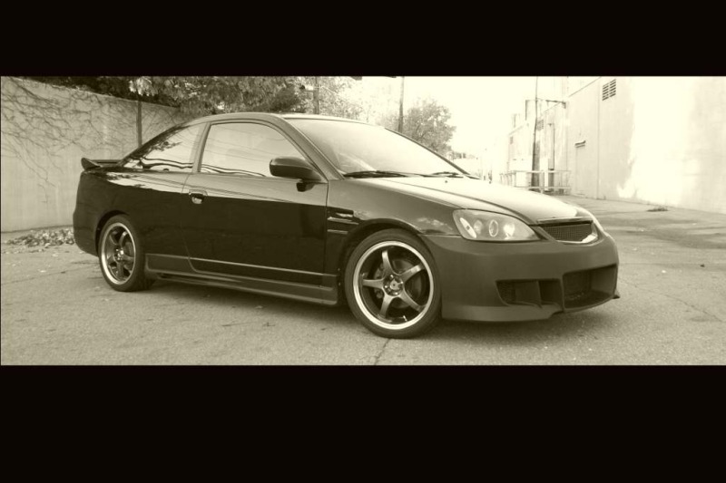

BTW: This is my ride......
ID:	50189   Click image for larger version

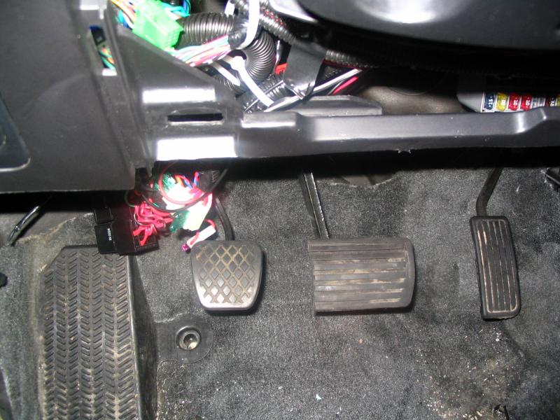

  #75
VTECTypeR's Avatar
Posts: 2,459
Is there anyway you can replace the brake pedal. I was thinkin of doing a auto the manual swap. How much did everything cost you with everything done

Originally Posted by 4drcivic2k1
What issues did you have with the Hasport mounts?
The drivers side bracket didnt line up with the holes. The hardware kits (nuts bolts and washers) were not right. Had to make a trip to the hardware store.
Simple, just get the manual brake pedal. I just cut it for now.

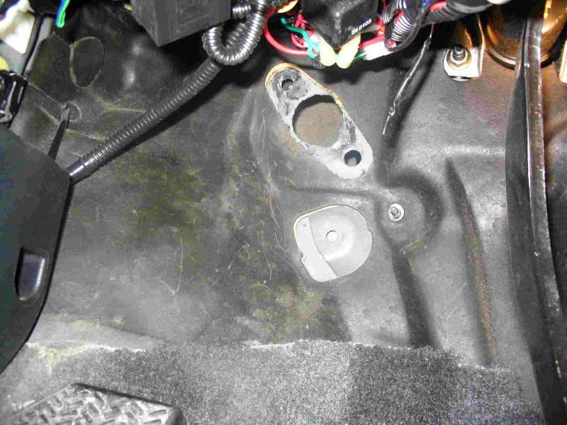

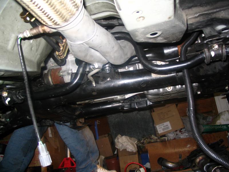

Some more pics.
ID:	50398   Click image for larger version
ID:	50399   Click image for larger version
ID:	50400   Click image for larger version
ID:	50401   Click image for larger version
