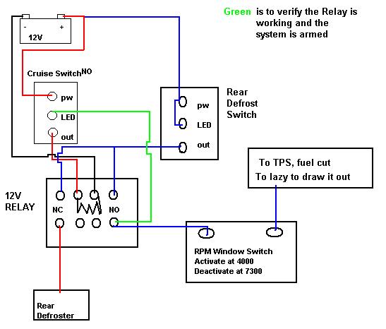

I had an idea for a sleeper switch setup. Don't know if will work because I'm not there to see how everything is actually wired. HAve to verify when I get back. I don't have cruise control, but I do have the slots for it. So I was gonna see how much a switch for cruise control is. Then run 12v to that. Run the other pole to a 12v relay to trigger the coil. The normally closed contacts would go to the Rear defroster so it could still be used under normal conditions. When it's time to have fun, arm the system by pressing the "Cruise Control" button. This will energize the relay coil and open the NC heater comtacts and close the NO contacts. Now power is just waiting at the Rear defrost button. As soon as I shift into second reach up(fast) and hit that Defrost which should instantly kick in the N20. Total sleeper. No suspicious big red switch for cops or challengers to question. Just another crazy Idea I had. Now I gotta work on hiding the bottle. I was thinking some kinda fake speaker box.
Here's a wiring diagram I just whipped up if it helps at all.
Speakerbox works, but becomes ungainly when removing your bottle for fill. Maybe my design sucked, but the easiest way I found to hide my bottle was slitting open the bottom of a gym bag, making side cuts for the braketry and hose, then having velcro to secure it back around the bottom. Just unzip to get your bottle out.
Not to mention it's alot easier to build than a new speakerbox, and it weighs a whole lot less.
Nice That's sounds perfect!
So far that's the best I've heard.
