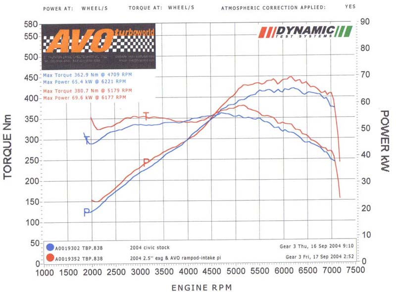

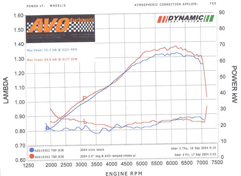

2 DYNO Pics of a stock Civic 2 weeks off the showroom floor after 1k Service.
The Next day a Run with an Exhaust stock extractors back 2.5" All the way with a High Flow Cat + Rampod Intake.
4.2 KW Increase for $**** dollars? Dam can't wait till I get some real power from the Nitrous SETUP!!!
Whats the formula for working out power at the wheels on the '04 vic? These numbers are at the engine!?

at the engine? That seems pretty low to be at the engine. It says power at the wheel/s on the dyno sheet which seems more reasonable to me. Are you gonna do a before and after the day you do your ZEX? As i stated before I am very interested to see what gains are to be had from the zex 55shot.
Are you sure that is from the engine (actually they measure from the fly wheel). But I just don't see someone removing the entire engine from a civic after two weeks to dyno a stock engine, not to metion that when you pull the motor and measure the power at the flywheel, it doesn't have an axhaust.
The only formula for going from the flywheel to the wheels is this:
if you have an auto, 20% of your power gets ate by the drive tranny, so a motor that make 100hp and 100 ft-lb will make 80 hp and 80 ft-lb.
if you have a manual, you have about a 16% drive train loss, so agian with the 100 hp at the flywheel, the power to the tires is 84 hp.
These are just generalization though that have been applies to all cars. I am not aware how closly Honda's follow these rules of thumb, but I see no reason why they would be any different than most car, they are not exact, but they can give you a rough estimation of the power being made by the engine.

The power on my Dyno is at the Wheels!! I went the wrong way round! So Ok I'm making 69.6 Kw at the wheels. So will see the diff after a 55 shot ZEX Kit.
