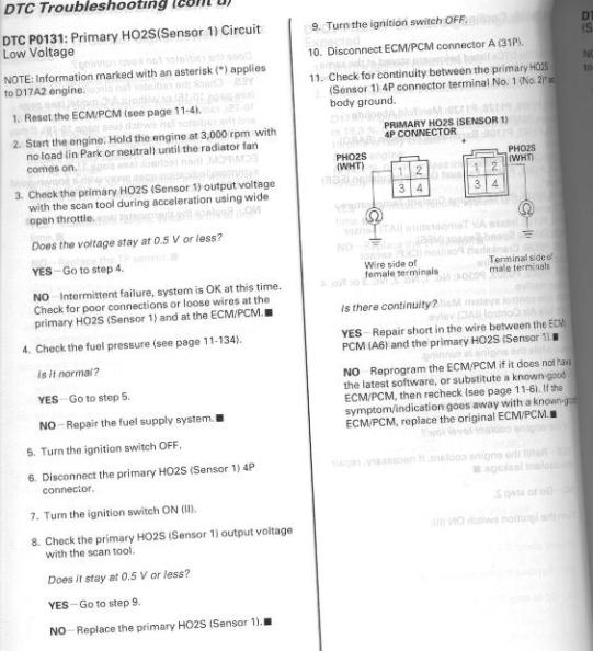

i have my turbo on my car for about 6months now and the first time I turned on my car it showed this error code, then after 3 days it went away, now I've been using 91/100 octane mix since then and I had no trouble...
but one time I ran out of gas and I have to put 91octane at a CITGO gas station... my CEL went off, I scanned it and it says:
---BANK ONE SUPER LEAN
---BANK ONE LOW VOLTS
I just got rid of the LEAN ERROR CODE but the LOW BOLT's been on for about 2 weeks now I know I need tuning... but is there anyway to fix this CEL? THANKS FOR THE HELP GUYS!

me and my boook!!!!

^^^where did you get the book? thanks bro i appreciate it!

i went to the dealer and they gave me a order form, otherwise www.helminc.com
