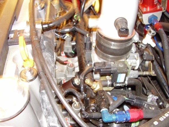

Does anyone have any pics of these injectors in their car? Ive heard that the studs that the fuel rails connect to would need to be made longer or changed. So does anyone have any pics of this?

word you have to remove the studs and put a bolt and spacers inbetween.

mine

^^^You got rc 440's? pretty nice. did you diy on the return conversion?

the FPR is aeromotive i think 1:1 and then pump is a walboro 255, everything has to be modified, even the pump housing

the plugs for the injectors on my car are not factory, spliced some obd1 on there i believe

no all you have to do is buy the injectors and replace the studs for the fuel rail with a longer one.
