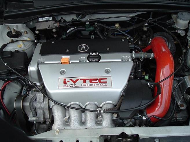

i haven't seen pics of the comptech SC, but the JRSC for the RSX won't fit. SI might with hood modification, i'm told. my engine bay has not PS yet in this pic, and you'd have to use SI electric power steering to fit an SC, i'm reasonably sure. if you want PS. there ain't much room in there, look at the intake manifold in an RSX-S bay and they have significantly more space than us.

Had a email conversation with Brian G from hasport, as i expected the JRSC for the RSX will not work do to a number of fitment reasons, but there is a possibility (like doubledeuce2k2 said) that the SI supercharger.

remember people, the si engine bay is the same size as ours... the rsx is bigger

yeah i also wondered this. I asked some guy on clubrsx and he said since they fit a k20a with a jackson racing supercharger in a si then it should fit our cars

again, electric PS on the SI is the difference in the engine bay.
see how there is just the one pulley on the passanger side? the PS hose goes right over that to the electric unit, i presume.
