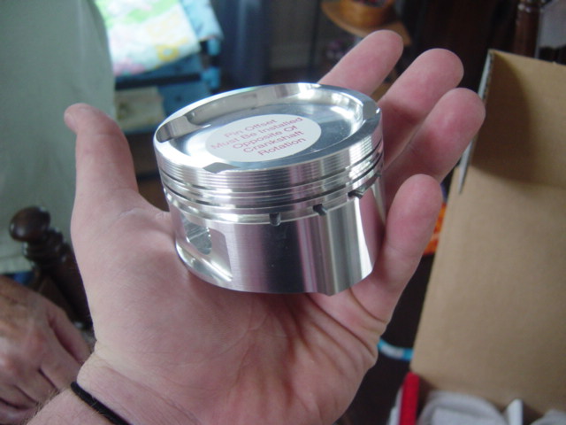

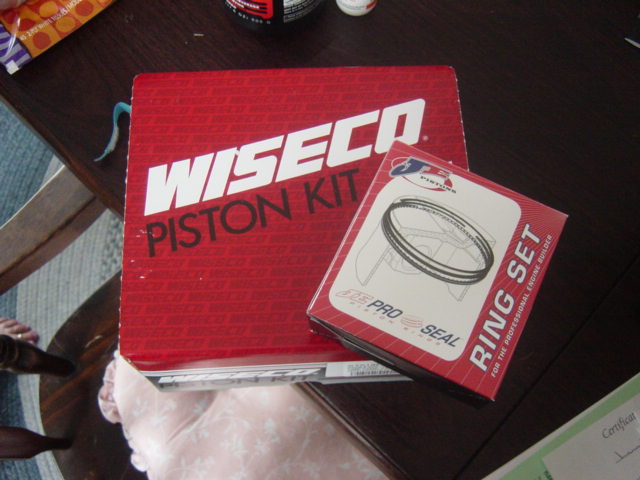

These came in the mail. Off to the machine-shop they go !

what do new pistons do? I never really understood that. Sorry im a nub.
unless the stock pistons are forged, these new pistons are probably stronger. They're also low compression pistons which is good for boosted engines. Lower compression means that you can add more boost safely.

Yeah, these are stronger pistons. They're forged and are a 9:1 compression ratio. They can handle a lot of boost....my engine would blow before they would. Also, the piston rings are good to 22 psi....so those should be safe too.

how much you pay for all of that?

$525 for the pistons and rings.

they must not be 75mm. or are they the stock 75mm?

They're 75 mm. They're going to the machine shop to get connected to the rods. The mech said that he's sending the old ones to the shop to get the pins heated and taken out. Then they're going to put the pistons on the rods and put the pins in and heat them up.
I guess it'll hold better ?
