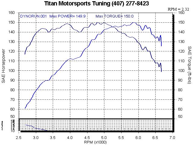

Well guys - just got back from dyno tuning the BEAST - Darren at Titan Motorsports did an AWESOME FVCKING JOB!
The first run was a baseline run, at 5 PSI. Amazingly, with a rough tune I made 150 HP, and 150 Ft/lbs of torque.

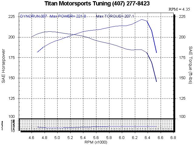

After a lot of tuning - we cranked up the boost controller (which held rock solid where it was set - no creep what-so-ever) to around 11 PSI.
Let me just say now, the numbers that the D17 put out were simply amazing! I don't plan on running 11 PSI daily however(10 at most at the track - don't want to blow the motor / head gasket). The results?
May I have the card please:
221 HP and 207 ft/lbs of torque!
Pretty damn impressive for a torqueless wonder....
Here are the dyno charts:
Baseline
11 PSI
