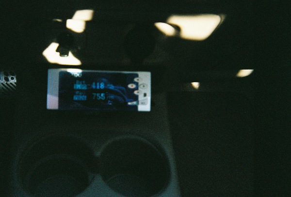

well for starters me right here has hit above 15 psi, if your going to take the time to put in pistons and rods, dont waste ur time on a blockguard. ERL Performance...they are in INDIANA, that is where my shop gets SLEEVES done. ive talked to the rep, they can do our engines, sleeves arent hard to get, i could have gotten them since day one, dont know why the FFFFF i didnt.
if you look at the peak boost on the top left corner.....ull see 1.05
