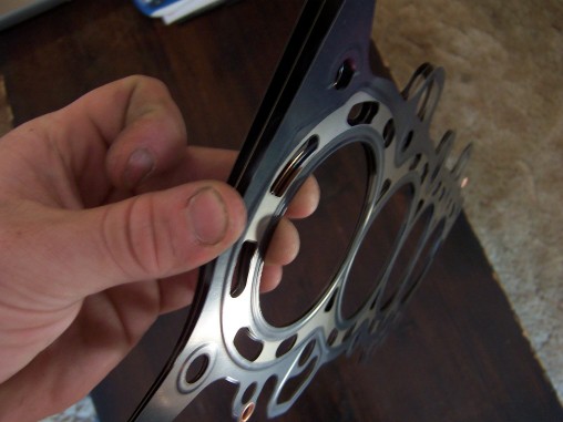

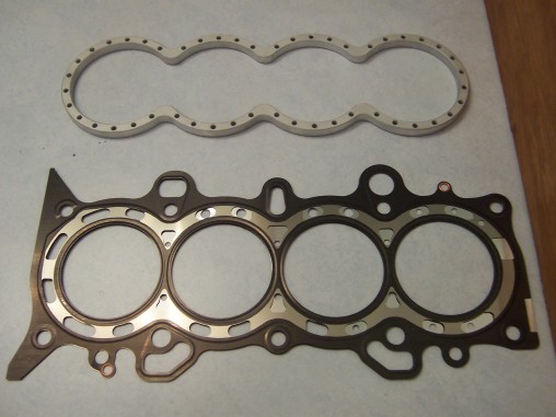

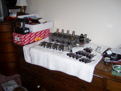

You might be a redneck if......you turn your spare bedroom into an automotive workshop hehe here's the pics

thanks it looks pretty dam good. does anyone have pics of the nippon?

sorry bro but the gasket in the first and second pic is the OEM one.
The stock gasket is 3 layers. Unless he changed the material in the center, he just sold you the nippon one.

anyone else know if this is the stock one? i've never had to take the head off yet so i haven't seen it.

its not in my car I can take pics of the oem one that just came out of my car single layer.

LOL im a dumbass. They were stuck together, my bad I found the difference though the raised rings that seal everything are much wider that even the squished oem ones. Phew I thought I got ripped off for a minute
