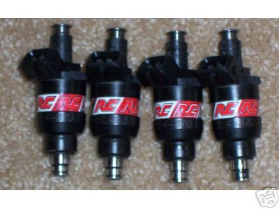

will these fit our civics?
370cc RC engineering fuel injectos..r these injectors mostly universal????? =D
Name:	370cc injectors.jpg

so rc injectors will fit our cars then??? =D =D =D

not perfectly
They are not a drop in solution - and would require some work to fit (TPS will need to be shaved, injector clips rewired, POSSIBLY injector seals massaged to fit). Only drop in solution with no modifications necessary (ok I lied - you need two spacers and two bolts) are RSX injectors...
