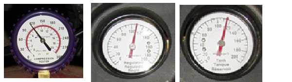

The gauge is dead accurate too. Here's a lil rig I made up. All were on the same pressure source...
So what could this be?
