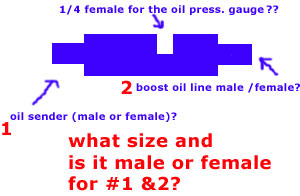

Question so like this?
AH!!!!!! ok.. i put my car in my garage on jack stands so i can get under my car. im going to check and recheck everything ... as far as the tap thing, im gonna go with something like this eventually http://www.greddy.com/products/produ...roductidx=1475
... gonna look at mcmaster.com to see what i need to get... off hand do u know the fitting for the oil sender i need?
is this diagram ok enuff? im trying hard guys.. reallly i am and i appreciate all your help!

Here you go, Rob, I'm going to make this super easy on you.
Oil Block
Pick up one of these and stick it between your filter and your block. You can run your oil pressure sender and your oil feed line for your turbo off of it. It's a little pricey but it saves you the hassle of having to mess with several fittings between the block and firewall. Order that with express shipping and it'll maybe take you 10 minutes to install and you don't have to search for brass fittings or sizes.

the picture doesnt do it justice lol.... is it the same thing as this?
http://www.alamomotorsports.com/prod...ckadapter.html
http://www.alamomotorsports.com/prod...apter.html</a>
Exact same thing. That's probably the easiest thing for you to do.
