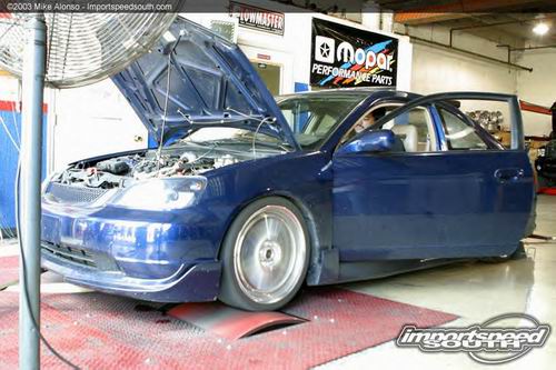

Dyno tuning your car....places your car on rollers. connects it to a computer and it tells you what HP ur making, where, what gear, and it charts your a/f curve. Then...with the use of something like a vafc, or an fmu, or an emanage, or hondata, etc etc, you fine tune the cars setting in order to make more power...and more efficiently across the board. Without tuning, you can be running the incorrect or unsafe settings, therefore increasing your chances of blowing up. Up side to dyno tuning is that you can seriously fine tune it so that you make an optimal amount of power. You can significantly increase your HP inone dyno session!!
You can technically do this yourself...but only if you have the know how. Here's ap ic of my car on a "dyno":

Originally posted by SpdRcrChk
Well in order to dyno tune you need a dyno. You dont have one, but i'm sure your local shops do.
What shop is that in Florida?
Old Mar 4, 2004
SpdRcrChk's Avatar
BOOST JUNKY
Joined: Nov 2001
Posts: 1,759
From: Wide Open Throttle
SpdRcrChk is an unknown quantity at this point
Lujan Motorsports in Miami.
