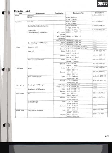

Does anyone know the specs on our heads. I am talking Valve sizes, Head dimensions.....whatever you can give me. Thanks guys..

here

well crap u cant read it, i guess if u want ull have to save it and zoom in or something

i can tell u this bro... they flow for CRAP.. worst honda head EVER for airflow... too concrned with fuel savings and emissions... thats why it takes almost twice as long to port our heads vs. any other honda head, the exhaust ports are TINY.. valves etc.. should be cool sized fromwhat ive read.......
